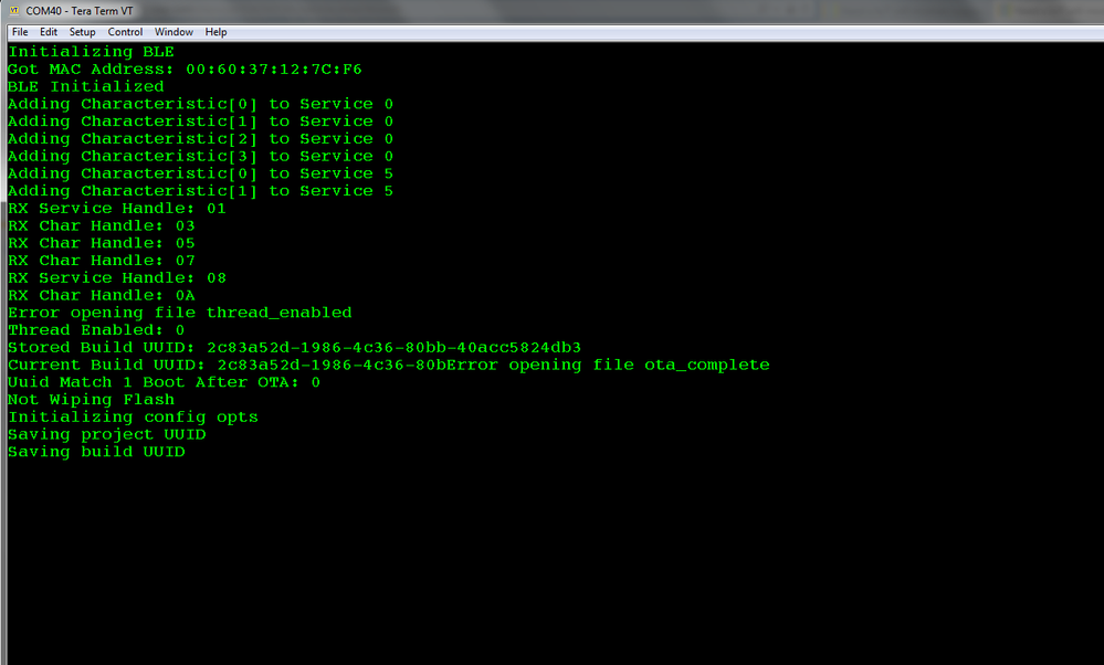

I am not sure about what your are requesting.
Connecting a Wifi module to Rapid IoT:
You can take a look at the Wifi modules MikroE is providing. You can connect thos module to the kit via a docking station
UART over USB:
It has been made available for projects compiled with Rapid Iot Studio:
Using a docking station, you can also have access to UART via a Terminal:

So you are looking for a UART example for your needs? Or do you need an SPI example?
You can try communicating your module with the K64 through one of the dock station pinouts,  do the signal processing in the K64, will that help your needs?

Practicaly I have connect this module to serial port by SECUIRE CRT,  but no data has recieved !
To activate the WIFI module  4 image files are necessary. This image has SFDP (Serial Flash Discoverable Parameter) of the serial flash which is installed on WIFI module and runs the active RTOS image.
Secondary bootloader
RTOS
RAM Library
PTIM
I think, UART is not a possible for bootloading, what do you think ?
JTAG is not necessary?

estephania_mart
If your module uses so many images, I believe that instead of thinking of the module you will need something bigger, as where will you store those images? In the Rapid IoT ? DO you have enough memory for that?
There are no libraries for PTIM for neither the KW41 nor the K64F.
You will need also the JTAG or SWD to debug, don't you?
