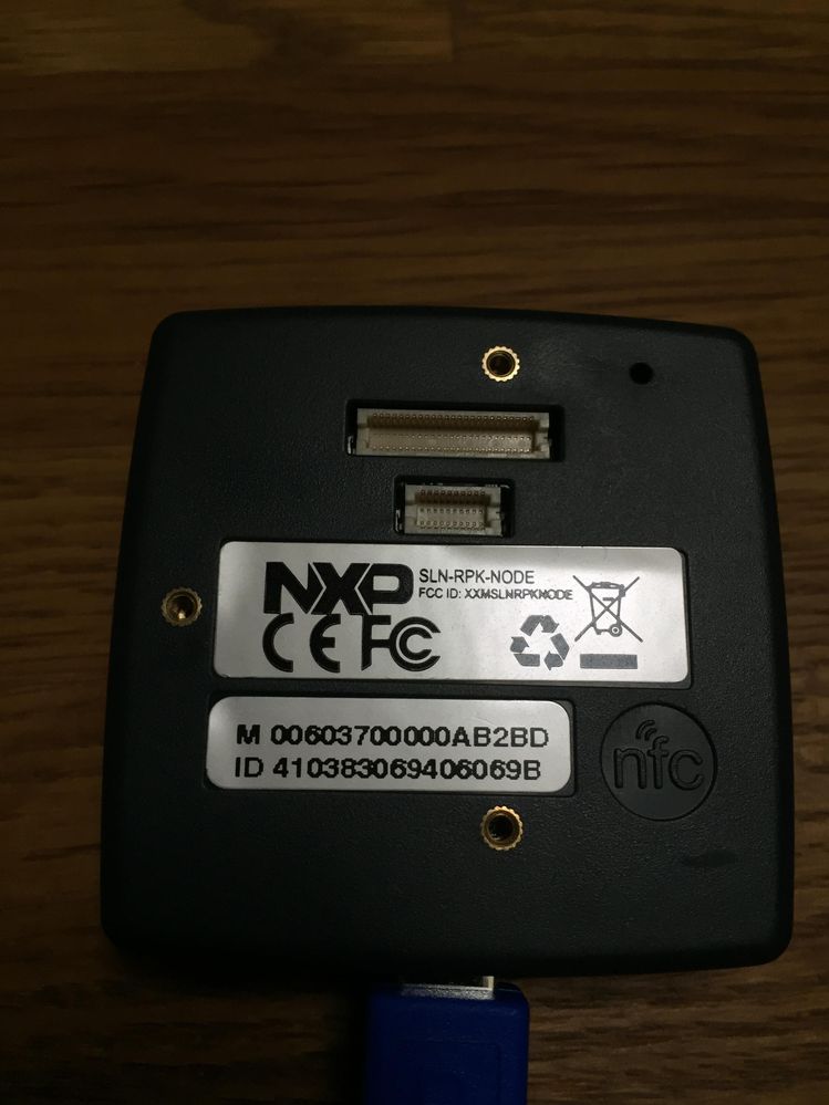

I am not able to provision my NXP Rapid IoT prototyping kit. The device is listed but when I click "Provision" all I get is "unable to authenticate device's hardware credentials" message. Same results with the Out of the box application as well as with my first application prepared based on the tutorial. Both NXP as well as my android mobile (Xiaomi Redmi Note 3) restarted several times - still the same results.

Hi Vilém,
What you described is quite surprising.
Normaly during the provisioning process, the kit is authentified by the server using a key stored in the A1006 component included in the kit. From what you describe it appears that your kit was not authentified for an unclear reason.
This means that, for now and via the Rapid IoT studio, you will not be able to provision the kit on our servers. The provisioning process breaks and you cannot connect the kit to the phone (application) over BLE.
In our stand alone weather station example:https://community.nxp.com/docs/DOC-342336
The authentication is not enabled via A1006 certificate and with this one you will be able to connect the kit to your phone over BLE.
Could you provide me with the serial number of your kit (to be found at the back) ? This will help me retrieving the test log of your kit. Rapid IoT are all tested ok before shipping but I will take a deep look in the log to check if I can detect something weird.

Hi Eric,
I followed the hint from Estephania (Reset & Reflashing the Out of the box application) without any success - it behaves still the same way.
Hereunder is the ID and Mac of my unit:
ID 410379789406069B, M 00603700000AAED9
I will try the weather station example over the weekend and let you know.
