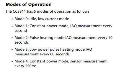

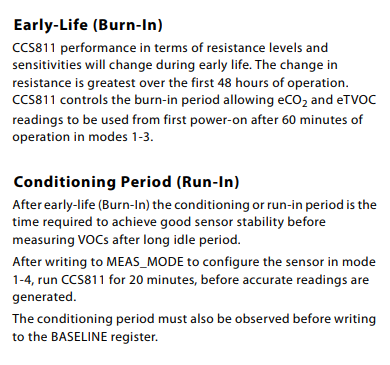

- From the CCS811 datasheet:

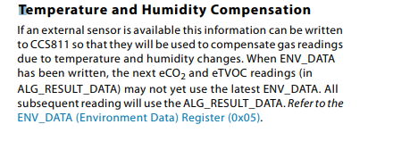

- Also same datasheet:
- There are also comments on the time ON for measurement. In our demo project, we are turning the CCS811 off as much as possible as it is consuming quite some current (We run in mode 2)

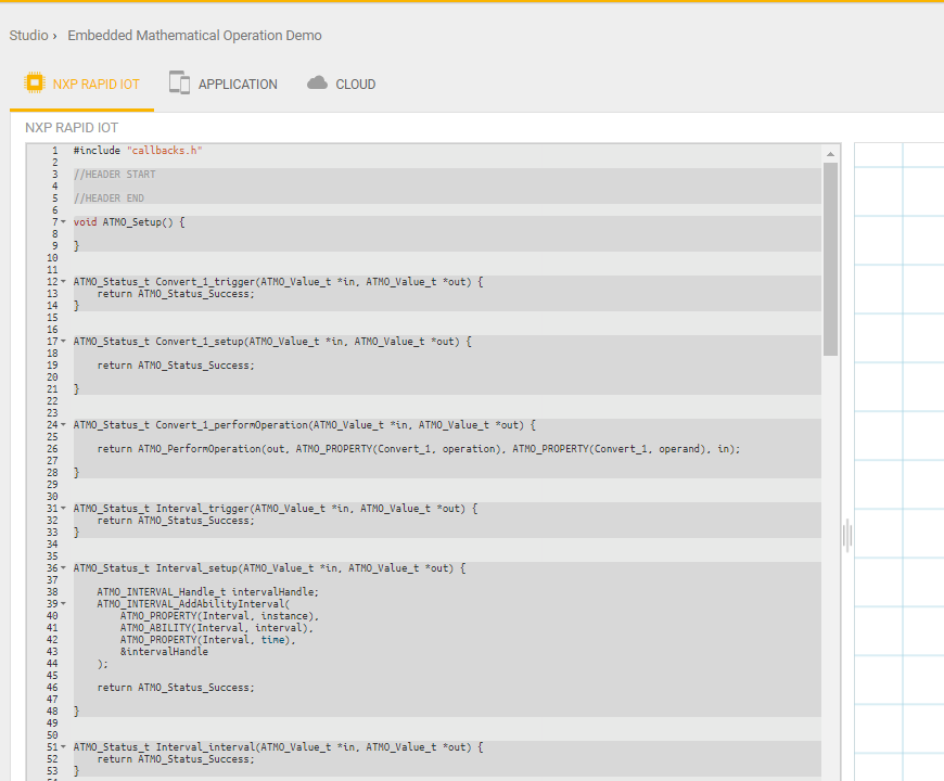

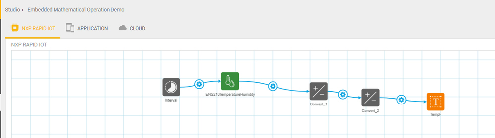

You have a couple of options depending on your skills but the CCS811 element in the Studio does not offer the possibility to adjust readings.
- Option 1: you can add a function element and do mathematical processing. There is an example called Embedded Mathematical Operation Demo in the demo project
- Option 2: you can modify the code in RApid IoT Studio:
- Option 3: you can export your code into MCUXpresso and write C code there

I was looking to send temperature and humidity values to CCS811 as per CCS811 datasheet you've provided to compensate gas readings using Rapid IoT Studio.
My interest in remote resetting of the device over BLE connection is a workaround to deal with CCS811 sensor reading drift. Sometimes this drift is so big that the only way I found to deal with it is a manual reset of the devise. So its gas readings get stabilized after it.

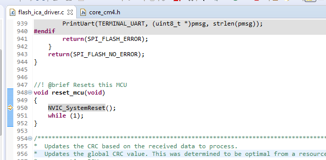

REtrieved where the SW reset is managed - Look for following code (reser_mcu) and pull the thread if you want to go down into details

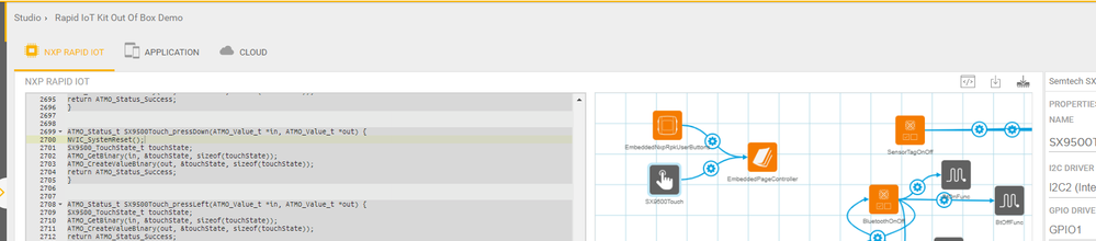

Thank you! Is it possible to call NVIC_SystemReset() from the code in Rapid IoT Studio?
7,345 Views
frq05186
Yes sure, see below:
Just call the function in the callback.
In my example, a reset will be triggered each time the down button is touched.
