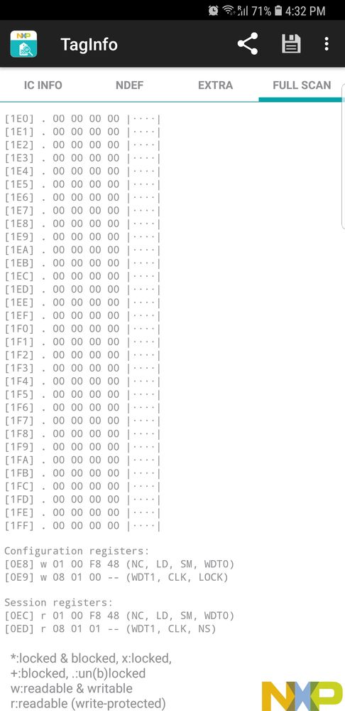

andreif
It looks like the tag has write protect, and I cannot revert it, I get this at the bottom of the tag read.
Though if the tag cannot be altered, what sense does the product make?
The rapid IoT studio has blocks for writing records on the tag? They do not seem to work either. I cannot get data on the tag in any way, should this be happening or am I missing something?

frq05186
From your screen shot it appears you have an android device and you are using TagInfo app.
In order for you to debug, did you try TagWriter ?
With this app you will be able to clear the tag content, enter the URL you want and check whether in your app it actually opens the URL.
Be aware that depending on the application you are using, it an be that the tag is ignored, therefore my advice to user tagWriter.
Once your URL is in the tag, just tap it with your phone wo being in any app, the URL should open automatically.

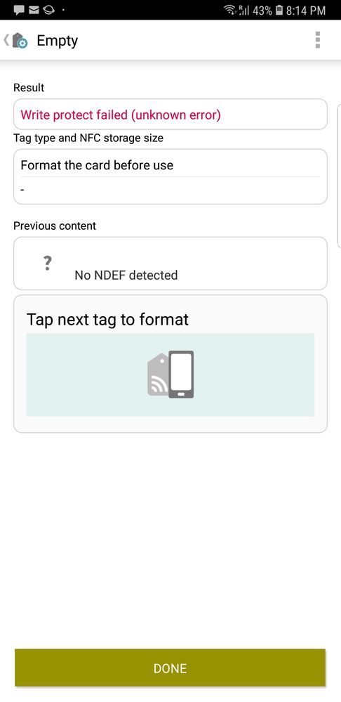

andreif
hi there,
I tried writing to the tag via the app, but that did not work, I am getting Store Failed. I have then tried to erase the tag, but that did not work either, I am not sure if I have to input the file size, I tried with and without defining it but I get the same error.
I cannot protect the tag either, basically, I can only read the tag (which is empty), any idea.
Andrei.
4,167 Views
andreif
I can erase it to factory settings but cannot format it as NDEF

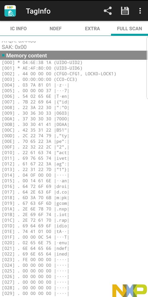

andreif
I have attached a screenshot of the data in the memory of the tag when scanned with the Tag Info app.Screenshot_20190121-224251_TagInfo.jpg
Andrei.
4,167 Views
estephania_mart
If you check the NDEF TAB you will see with more details the messages.
If you really want to understand the memory mapping of the NTAG I2C, I would strongly recommend you to check the following video <NFC Products: NTAG I2C plus-Your entryway to NFC|NXP > which it's just a quick introduction to the device.
To make sure I fully understood you, you want to write your own URL in the NTAG of the Rapid IoT so when it gets tapped it opens the web link ?
