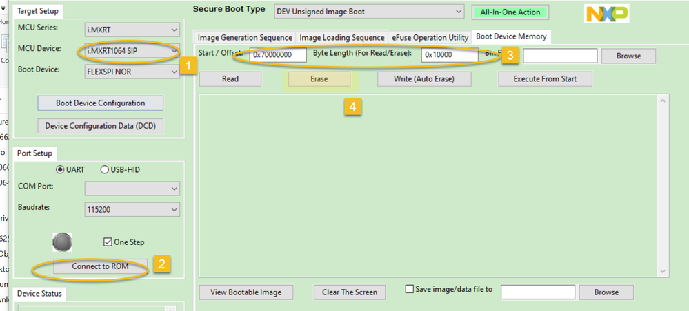

This issue should be caused by the invalid code is downloaded to the internal flash, which is in fact also the external Winbond QSPI flash, just put in the RT1064 internal chip. Then the debugger will be influenced, it is know issue.
Normally, when meet this issue, customer can enter the serial download mode, and erase all the flash to recover it.
Now, follow me to do it, you can use the MCUBootUtility to finish it.
https://github.com/JayHeng/NXP-MCUBootUtility/archive/v2.4.0.zip
the related user manual is:
Then enter the serial downoad mode:SW7:1-OFF,2-OFF,3-OFF,4-ON, power off and power on the board again.
Use the MCUBootUtility to connect your board through the COM, you also can use the USB but you need to connect another USB cable to J9.
After you connect the to the ROM, then you can select the Boot Device Memory, fill the Start address as the MIMXRT1064 flash memory address 0x70000000, length, you can fill 0x10000.
Then click the erase.
After you erase the memory, change the boot mode to internal boot again:SW7:1-OFF,2-OFF,3-ON,4-OFF, power off and power on the board again.
Now, you should can use the MCUXpresso Debug your board again.
You can try it on your side.
If you still have questions about it, please kindly let me know.
Kerry

kerryzhou
MCU device should be RT1064 SIP, you are using the rt106x, it's wrong, try it again.

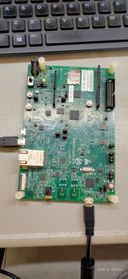

kerryzhou
Give me your whole connection board photo, I will check your hardware connections and the configurations.
30,609 Views
kalyan1
30,604 Views
kerryzhou
Didn't find any connection issues, that's strange.

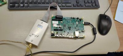

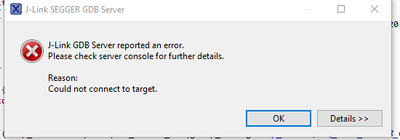

kalyan1
 we have connected through jlink and tried to flash the program but still we are facing the issue, if hardware issue please let us  know how to resolve it..

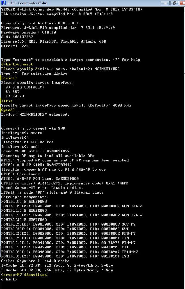

kerryzhou
Hi kalyan1,
  Remove on board J47,J48,J49, J50 jumper.
  Power off and power on the board again, then use the JLINK commander window.
  You can find the JLINK commander window in the JLINK driver install path.
  Then, use the SWD interface to connect your board, this is the RT1050 JLINK commander example, for your reference:
Can you find the ARM core or not?
Any updated information, please kindly let me know.
Kerry

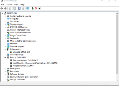

kerryzhou
Hi kalyan1,
  Thanks for your feedback.
  Do you have another USB cable?
   If yes, please plug it to the on board J9, then press the reset button.
   In the MCUBootUtility, Select the USB-HID, can you find the PID VID?
Kerry
