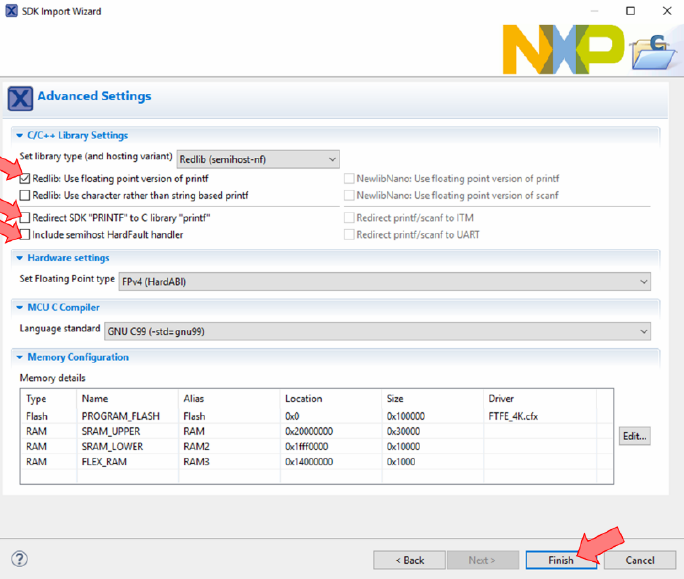

-> Import "hello world" project from SDK examples.
-> In the advanced settings page, uncheck the two options redirect SDK “PRINTF” to C library “printf” and Include semihost Hardfault handler and check the option Redlib: Use floating point version of printf, then press Finish.

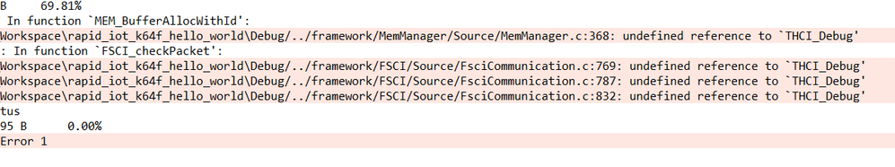

Then compile your project in-case if you get below errors
Fix it by replacing " THCI_Debug" by "printf"

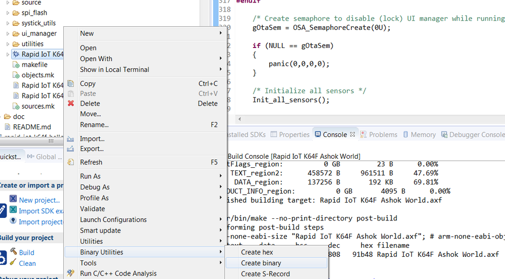

After compilation success , Generate your ".bin" file like shown below

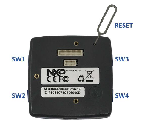

Press & hold  Top-Left button (SW3) then reset the kit to enter into USB flash mode.
flash the bin into your Rapid Kit by simple drag and drop.

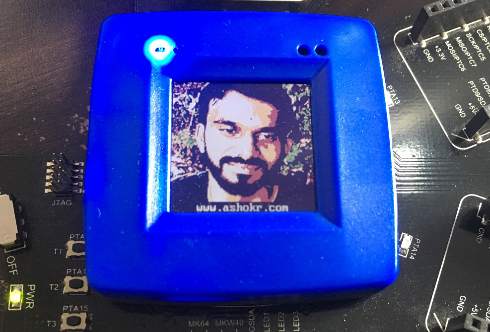

Text "Hello World" will be displayed on your Rapid IoT Kit
To set image use this line "GUI_BMP_Draw(_ashok_bmp111, 0, 0);"  BMP image should be in RGB(1,1,1) 4bit format.
