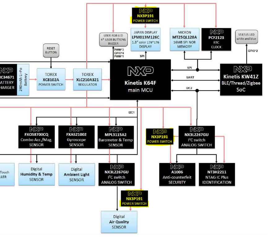

I've used a Weather demo to measure battery usage by device. Even if I switch backlight off it only lasts for 2-3 hours (with active BLE connection).
I'm now trying to increase reporting interval from 1 to 10 seconds to reduce energy consumption.
Is it really the case that I can't really switch sensors off.(using IoT Studio) and it only possible to switch data reporting off?
What other options should I consider to reduce its power budget?

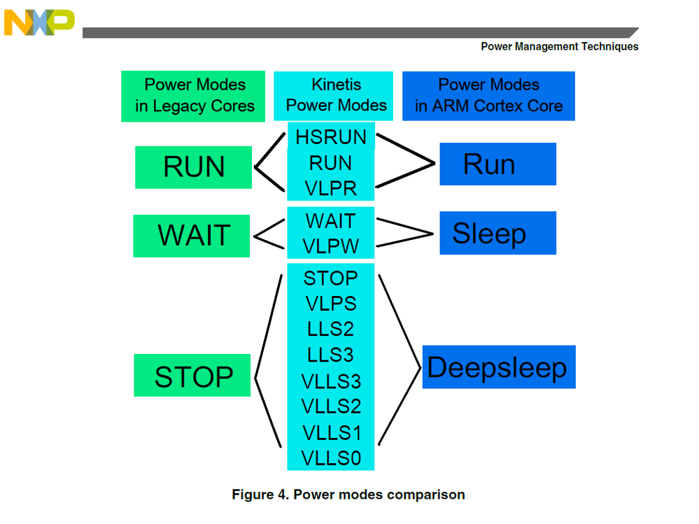

Secondly, you can put main MCU that is K64F in WAIT, SLEEP, DEEPSLEEP  modes. To know more about those features, please take a look at this application note: https://www.nxp.com/docs/en/application-note/AN4503.pdf
The last thing you can do is to turn off power switches on certain sensors that are energy-consuming like Air quality sensor, A1006 authentification, and ofc if you don't need it, display.

vassily98
You can disable sensors via the code editor from any function, even at the start in the ATMO_Setup().
For example for the temperature sensor the code is the following:
ATMO_ENS210_SetEnabled(false);
