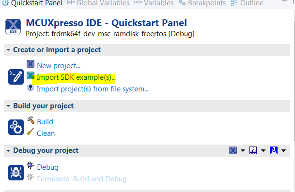

  • maybe I have done again something wrong: after importing into MCUXpresso, and doing "import project into filesystem', selecting the folder of the K64 SDK (\SLN-RPK-NODE-SDK\SDK_2.3.0_RapidIoT_MK64F12), the only project that appears is kboot_k64t.
When importing SDK into MCUXpresso, the hello world project should be imported using "Import SDK example(s)" option.

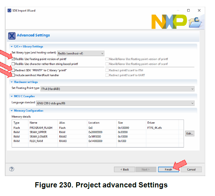

This one is a known issue, you have to follow the instructions in User Guide at paragraph:
    4.3.2.3. Import the Hello World project for Rapid IoT.
Make sure to untick:
- "Redirect SDK printf to C library"
- "Include Semihost HardFault handler"
Make sure to tick:
-"Redlib: Use floating point version of printf"
Please mark the answer as helpful if this solves your issue,
Theophile,
4,130 Views
marcomerlin
Thank you, I got it compiling that way!
