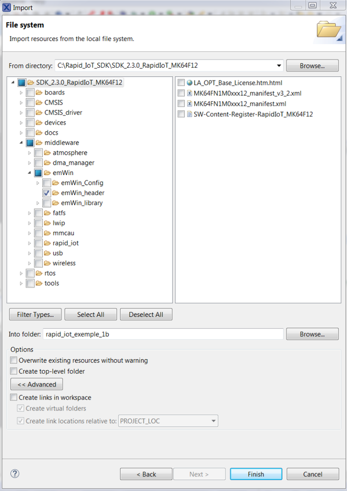

Using MCUXpresso with the SDK_2.x_RapidIoT_MK64F12 (2.3.0) I'm trying to build the 'hello world' app as instructed here NXP Rapid IoT Prototyping Kit|NXP
The compiler can't find the file GUI.h, it isn't in the SDK  ?

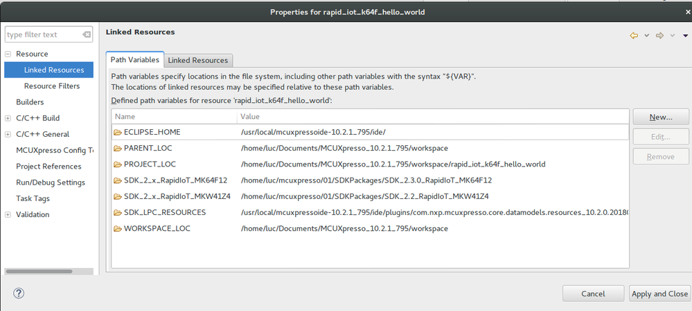

Can you capture the settings in project properties -> ressources -> Linked ressources ?
Did you try importing manually the missing files via "import from file system" option ?
Right click on projet -> Import -> General, File System -> Browse the missing files
Théophile
10,050件の閲覧回数
luc_de_pauw
Hello Théophile,
Linked resources:

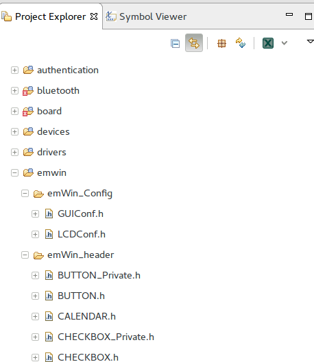

Importing on sublevel folder ex. emWin_Config works, but when importing from level emwin nothing get's imported, also no error message. So after importing the 3 subfolders emWin_config, emWin_Library, emWin_library via import File system menu I can see them in the project explorer.
Still some issues after clean/build, seems the 'gui' included files are not recognized by build process.
In the IDE when I click on the GUI.h in an include statement the correct include file opens in the IDE.
Luc
