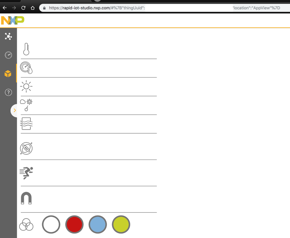

Although I am able to see the data from the 'Out-Of-Box-Demo' app update regularly on my iPhone's Application view:

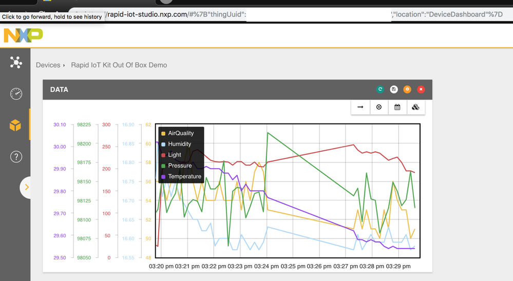

When I open the exact same view on my browser, I don't see any updates on the application view despite seeing the data update on the graphs. Is this a known issue/limitation?

Hi Frak,
Did you enable the wifi connection in your iPhone?
Are you able to turn on/off the RGB Led?
Please let me know your findings
Mario

frakman
Hi Mario.
Thanks for the follow-up. Regarding your questions:
- Did you enable the wifi connection in your iPhone?
Yes. The graph on the website wouldn't be updating otherwise.
Do you mean the circles on the bottom of the App view? No. They are un-responsive.

mario_castaneda
Hi Frak,
Could you please follow the next community post? Could you please reboot the Rapid IoT?
https://community.nxp.com/docs/DOC-342183
Please let me know if you are still facing this issue.
Mario
