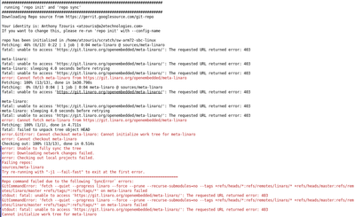

Build worked on early Friday 4/11/2025 and then mid-Friday it stopped working. I did find a workaround to allow my build to complete. Workaround is to remove the two lines with reference to linaro in file ~/.repo/manifests/default.xml (link to ls-6.6.52-2.2.0.xml). Can I get a response for confirmation if this is a proper fix? I suspect that a repo has been moved/redirected/other. Please advise.
Build machine is ... Ubuntu 22.04.5 LTS
Main error is ...
fatal: unable to access 'https://git.linaro.org/openembedded/meta-linaro/': The requested URL returned error: 403
I am able to successfully build an earlier and later releases ls-6.1.55-2.2.0.xml and 6.12.3-1.0.0.xml.

Fetching: 46% (6/13) 0:22 | 1 job | 0:05 meta-linaro @ sources/meta-linaro
meta-linaro:
meta-linaro: sleeping 4.0 seconds before retrying
error: Cannot fetch meta-linaro from https://git.linaro.org/openembedded/meta-linaro
Fetching: 100% (13/13), done in 1m26.889s
Fetching: 0% (0/1) 0:04 | 1 job | 0:04 meta-linaro @ sources/meta-linaro
meta-linaro:
Fetching: 100% (1/1), done in 4.674s
fatal: failed to unpack tree object HEAD
error.GitError: Cannot checkout meta-linaro: Cannot initialize work tree for meta-linaro
error: Cannot checkout meta-linaro
Checking out: 100% (13/13), done in 0.563s
error: Unable to fully sync the tree
error: Downloading network changes failed.
error: Checking out local projects failed.
Failing repos:
sources/meta-linaro
Try re-running with "-j1 --fail-fast" to exit at the first error.
Repo command failed due to the following `SyncError` errors:
GitCommandError: 'fetch --quiet --progress linaro --force --prune --recurse-submodules=no --tags +refs/heads/*:refs/remotes/linaro/* +refs/heads/master:refs/remotes/linaro/master +refs/tags/*:refs/tags/*' on meta-linaro failed
stdout: fatal: unable to access 'https://git.linaro.org/openembedded/meta-linaro/': The requested URL returned error: 403
user@host:~/deleteme/scarthgap-6.6.52-2.2.0$

I have reported this issue to the LSDK development team.
Your workaround is fine.

This is what I get run
ning the google repo command this morning ...
382 Views
yipingwang
Recipe meta-linaro folder is useless in the building, so you could ignore this error.
