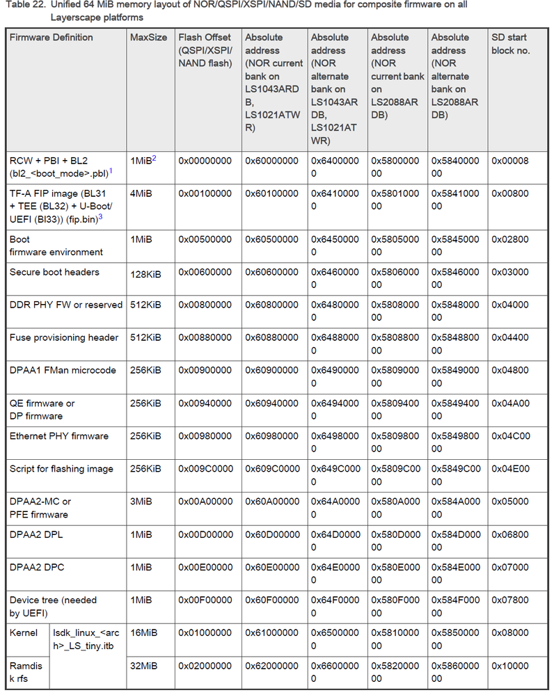

Hi Team,
Hi As per documents "LSDKYOCTOUG.pdf" we are able to load board ls2088ardb with below yocto images successfully.
1)tftp 0x82000000 Image-ls2088ardb.bin
2)tftp 0xa0000000 fsl-image-networking-ls2088ardb-20220218070510.rootfs.ext2.gz.u-boot
3)tftp 0x8f000000 fsl-ls2088a-rdb.dtb
4)booti 0x82000000 0xa0000000 0x8f000000
But can you share the write address (or procedure) for the u-boot flash. So that we can write our images on the board LS2088ardb.
Prafull
Please refer to the following NOR flash memory layout on LS2088ARDB.
