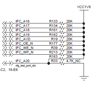

Please provide PVR and SVR values for the processors on both boards.
Ensure that IFC_A[16:20] are not pulled down during power-on reset. This pin may be pulled up, driven high, or if there are any connected devices, left in tristate. If this pin is connected to a device that pulls down during reset, an external pull-up is required to drive this pin to a safe state during reset.

All are pulled up.

When the POR and the IFC_A[16:20] signal to the digital scope as follows. Both are identical.
