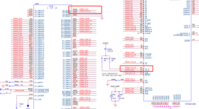

Dear team,
 we use ls1043ardb to evaluate HW and SW things on DDR peripheral as spec DDR Bringing up and validation with QCVS DDRv instrution.
But there is no DDR_CLK output,is the phenomenon right?

Please refer to the attachment.
