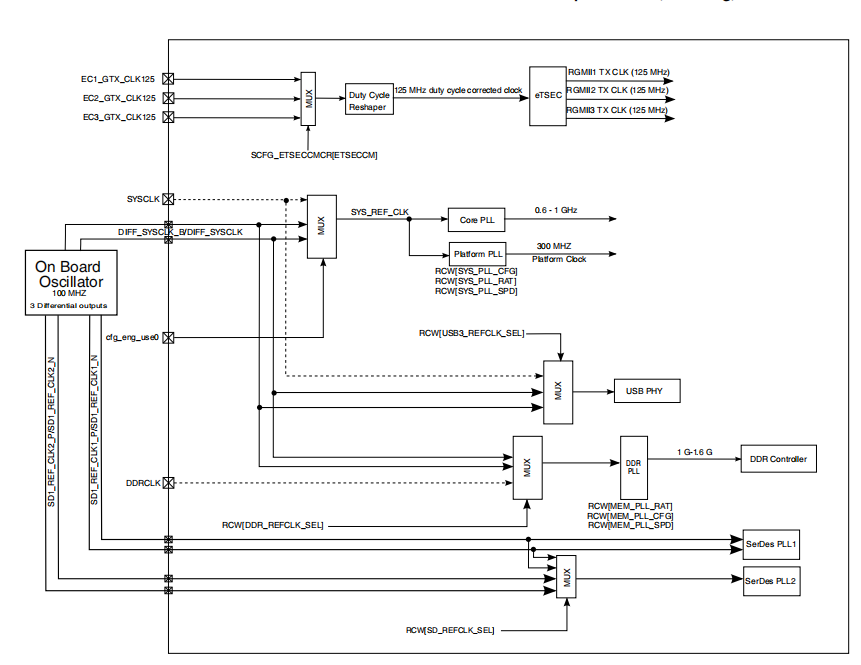

hi everyone,
i m facing problemes with a microcontroler based on ls1021a (it is the tqmls1021a-cc). We are trying to disable the SERDES module with the RCW using the  ref manual. section  32.1.1.1.2.1 procedure.
PBL preamble and RCW header
aa55aa55 01ee0100
 0             32              64            92
 0608000a 00000000 00000000 00000000
128          160           192            224
FF000000 00C07900 40025a00 21046000 (boot failures)
07000000 00007900 40025a00 21046000 ( with this configuration we boot. With any other one we don't)
256         288           320           352
00000000 00000000 00000000 000bc800
384         416           448           480         512
20124900 0004b340 00000000 00000000
Are we missing something in the procedure to disable the serdes module properly ?
We would like to  use etsec2 has RGMII. But we think that the SERDES module initialize some register during power on reset to force the controller to be in SGMII. this is why we need to be able to turn the SERDES module off.

So far we don't know yet if its possbile to configure etsec2 properly for RGMII mode with the SERDES module powered on.
We are using QCVS to generate RCW.
thank you for your support.

1) I could check RCW if it will be provided as binary image.
2) To configure the eTSEC2 into RGMII mode it is required to select RCW[EC2]=000 (RGMII2).

Hi Ufedor,
We found our problem, it was related to our pbi. For a while i was investigating only on the RCW side. At some point i went to check the pbi and a mistake was made.  There was a PBI command  (09ea00e4 10000000) that was writing to the SERDES modules and explained the undifined behavior we encountered about RGMII for etsec2.

marcojankovic
Hi ufedor,
thanks for your reply,
The yellow field correspond to etsec 1,2 and 3 configurations (they are already set to 000 wich is RGMII).
The green one concerns the SERDES fields.
this is our current RCW wich we can boot on properly :
 0             32              64            92
128          160           192            224
70000000 00007900 40025a00 21046000
256         288           320           352
384         416           448           480         512
If the byte 128 value is 0x70, our module boots. But any try to change the SERDES mode leads to  boot failures.
We are using QCVS to build our RCW.
I attached to my reply our RCW binary generated with QCVS corresponding to our configuration that boots. (RCW_PBL.bin)
And our test with our RCW with the  SERDES  module off that does not boot based on the steps described in the ls1021a ref manual (32.1.1.1.2.1 Disabling unused SerDes modules) . To enable the generation of this RCW under QVCS, we had to unable the option "Enabling Ignore Constraints and non-Critical Errors option" (RCW_SERDES_OFF.bin)
