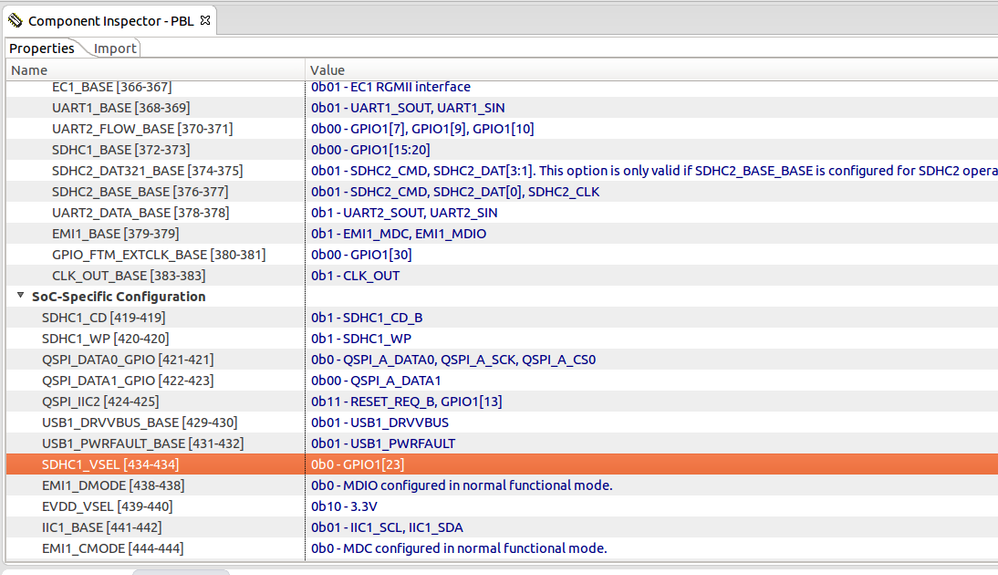

But , I changed SDHC1_BASE to GPIOs
1,893 Views
ufedor
The RCW[SDHC1_BASE]  controls GPIO1[15:20].
1,893 Views
ufedor
What is the RCW source?
1,893 Views
nattapongsungch
Hello ufedor,
I'm using QCVS import PBL_0x35_0x08_800_250_1000_default.bin from LS1012A-SDK-AARCH64-IMAGE-20160830-yocto/ls1012ardb/
And change SDHC1_VSEL is GPIO and SDHC1_BASE are GPIOs.
Thank you,
Nattapong
