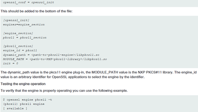

we are testing 'PKCS11' using LSDK 20.04
following 6.5.3.3.2 PKCS#11 based OpenSSL Engine (Third party OpenSC/libp11)
we want success 'openssl engine pkcs11 -t' command
(pkcs11) pkcs11 engine
[ available ]

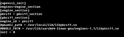

and our /etc/ssl/openssl.cnf
thank you

Please edit /etc/ssl/openssl.cnf  as the following.
[openssl_init]
engines=engine_section
[engine_section]
pkcs11 = pkcs11_section
[pkcs11_section]
engine_id = pkcs11
dynamic_path = /usr/lib/aarch64-linux-gnu/engines-1.1/libpkcs11.so
MODULE_PATH = /usr/local/lib/libpkcs11.so
init = 0

pkcs11 engine for OpenSSL can be installed on board using command sudo apt-get install libengine-pkcs11-openssl
Above command will install the libpkcs11.so (pkcs11 engine) in /usr/lib/aarch64-linux-gnu/engines-1.1/libpkcs11.so and this
will be dynamic_path in OpenSSL configuration file.

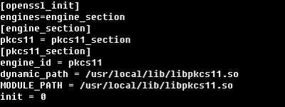

dongyeonkim01
thank you for your reply
I find libpkcs11.so  file
but I make another errors
and my /etc/ssl/openssl.cnf
(chantge dynamic path, module path)
+) add
