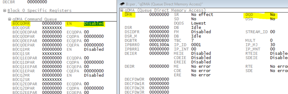

When I try to register and start qDMA function on LS1043A
It blocked in the first step.
following the manual reference, we should Disable the command queue.
but if set the register DMR[DQD]=1, BaCQbMR[EN]=0,  the two register could not be write succesful
(the memory map is OK)
I try write manage and block register, most of them also could not be wrote successful.
then I use TRACE32 debugged on u-boot mode, and try to modified the memory value directly
but it still doesn't work.
so it there any pre-condition for the qDMA functional on LS1043A?
how can we use it normally
P.S:  I check the CSU\ device configuration, it is OK.  and I have switch the secure state to EL3, but it does not work.

Thanks a lot for your reply.  I still blocked on the first steps. following the first steps your suggestion: "Try to halt the qDMA engine first", when I use TRACE32 tool attached LS1043A on u-boot mode, try to change the qDMA register directly. (DMR[DQD], BaCQbMR[EN]), but the register could not be access.(could not be changed)
May be I miss or make some mistake. so I have two questions
Q1: for the step one:  "Try to halt the qDMA engine first",  I try to change the DMR[DQD] and BaCQbMR[EN] register value, is it right?
Q2: following the QorIQ LS1043A Reference Manual, Rev. 5, the Privileged registers may should be access under hypervisor mode. so I switch the exception level to EL3.  but it still does not work.
so pls give us a suggestion way to access the Privileged registers

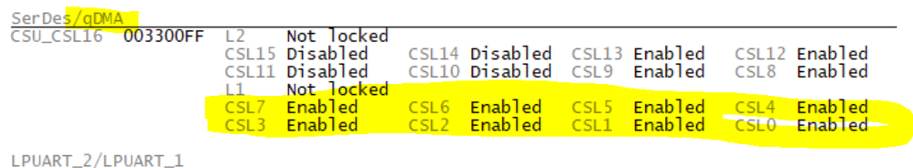

so pls give us a suggestion way to access the Privileged registers [NXP] The Central Security Unit (CSU) sets access privilege levels for peripherals. Please check the config security level of qDMA registers at 0x151_0040. Unlock it using L1 bit and enable all SL0:7 for qDMA registers. For more details, refer CSU Memory Map/Register Definition of LS1043ARM.

1. set CSU_CSL register and try to halt qDMA engine, but DMR[DQD] and BaCQbMR[EN] could not be set

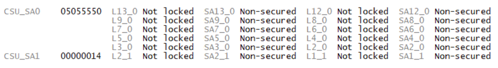

2. I also try enable all the CSU_SA register as below, but qDMA register still can not be write

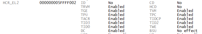

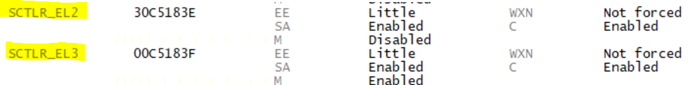

3.  I short the J13 and make TA_PROG_SFP power on. follow ARMv8 A53 framework. I enable all the register of the SCTLR_EL and HCR_EL2 or SCTLR_EL3 section to switch the EL2(hyp) or EL3 security level. but it still does not work

by the way , on the default setting . only  DMR[DQOS] and DMR[TCD] and a few interrupt register can be changed.
but other important register still can not be write.
I access register bit directly on TRACE32 tool. so the address and little/big-endian format should not effect the result
pls help me review the problem.
