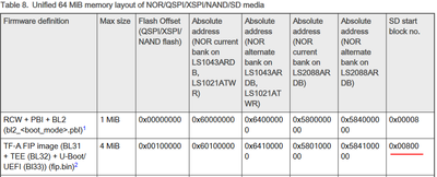

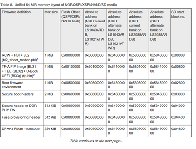

imuguruza
I am wondering if the fip file offset is correct. Checking the Yocto doc, I've found the next table:
So, instead of using the suggested 204 offset shouldn't be the 800?
Still I have tried that out and doesn't work... I am missing something else? :'\
imuguruza
2,443 Views
yipingwang
My mistake, it should be
Please deploy TF-A FIP image at 0x00800 in SD card.
dd if=fip_uboot.bin of=/dev/sdb bs=512 seek=2048
2,431 Views
imuguruza
Yeahp, now it works:
so the bs is just 0x800 is decimal... I didn't try that

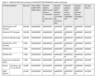

imuguruza
OK, I have been reviweing the doc.
Should I apply the offset suggested in the next table using dd for flashinf the different binaries?
But, how can I generate the itb file? Using mkimage? Which command should I use?
That's a compressed rfs, how can I use an uncompressed rfs? Should I change the bootargs to point that out? How and where?
I am missing all that info...
