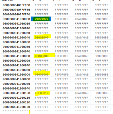

Issue: When performing a flash page program command, an issue occurs with data transmission from the TX buffer. The initial data transmission behavior exhibits anomalies before resuming normal operation.
  • During the first transmission from the TX buffer, the first word of the data transmitted is 0, followed by valid data until the first time buffer is fully transmitted (16 words).
  • the operation is repeated with smaller transmissions:
    • 4 words at a time: The first word sent is 0, and the following three words contain the correct data. This pattern continues for four transmissions before normal operation resumes.
    • 8 words at a time: The first word transmitted is 0, followed by seven words of correct data. This pattern continues for two transmissions before normal operation resumes.

It appears that clearing the TX FIFO with the CLR_TXF and CLR_RXF bits in the QuadSPI_MCR register only works correctly after performing a software reset on both the AHB and serial flash domains. Post-reset, the TX FIFO behavior aligns with expectations, and the values in QuadSPI_FR and QuadSPI_TBSR registers are as anticipated.
Could you confirm if this workaround is recommended or if it’s an indication of a potential misconfiguration?
998 Views
yipingwang
This behavior is not observed on the LS1046A device. You can use the mentioned workaround if that works fine to you. If needed, we will share the QSPI driver file for your reference in case you are missing anything.
