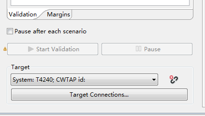

cai_tx
I try with CWTAP without providing id .but it can't start validation,it dispaly the informations as follows:
"something wrong with target connection".
if I do't purchase DDR Valiation tool ,then I can't use the tool, yes or no ?

addiyi
You can use DDR Validation for 15 days after you installation. After this period you have to purchase a licence.

cai_tx
OK,I Known
now I have one question that I can't connect to my board,so I can't Start validation!
whether can you privide assitant ?
informations:
"There is something wrong with the target connection,please correct the issue to be able to run validation on the selected target"

mathiasparnaude
I remember when I tried to use it, I had problems like that to get a connection.
I faced problems of versions of shared objects. It was highlighted running CDDE:
/opt/YourCodeWarriorPath/eclipse/Optimization/target-connection/cdde/cdde-linux/bin/cdde
Where I got that:
"error while loading shared libraries: libexpat.so.0: cannot open shared object file: No such file or directory"
I solved this error creating a symbolic link: /lib/libexpat.so.0 -> /lib/libexpat.so.1.5.2

addiyi
USB TAP probe is no longer officially supported. While QCVS allows connection using USB TAP probe for some device that might not work. Instead, we strongly advise using CodeWarrior TAP probe.
