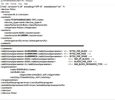

I was trying to add NAND flash device on my custom T2081 board.
I have followed the instructions suggested by you such as updating xml file as per our part number used, configuring IFC memory registers but i am unable to connect with NAND Flash.
Please find the attached datasheet and let me know what can be the device ID as i am unable to decode it from the datasheet.
Also, please verify the attached updated XML file for MT29F64G08AECABH1-10ITZ:A TR.
Hemant

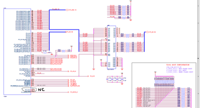

yipingwang
Please check the proper hardware problem.
Please specify proper clock for IFC modules
17,523件の閲覧回数
hemanttiwari199
Its a custom T2081 board without CPLD. So from where I can get the IFC Clock Details or i have derived the same from the datasheet.
For your reference I am attaching IFC interface diagram.
Hemant
