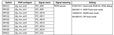

hemanttiwari199
1) HRESET_B must not be driven by an external source.
---> It is Driven by 1.8V present in the system
2) Which cfg_rcw_src is selected?
--->We have selected Hard-code RCW i.e. 010011011
What are POR voltages on {IFC_AD[8:15], IFC_CLE}?
--->All the IFC_AD[8:15], IFC_CLE are connected to 1.8V.
Attaching the reset circuit for review.

ufedor
HRESET_B must be driven by open-drain gate - refer to the AN4804 - QorIQ T2080 Design Checklist, Figure 3. JTAG interface connection, note 7.
It is not clear how to interpret provided traces because they do not contain PORESET_B signal.
1) Is the schematics page 8 accurate and the cfg_rcw_src really is strapped to 0_10011011?
The 0_10011011 is not documented in the QorIQ T2080 Reference Manual, Table 4-15. Hard-Coded RCW Options.

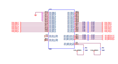

2) Which SerDes reference clocks are applied?
Refer to the QorIQ T2080 Reference Manual, Table 4-16. RCW Settings for Hard-Coded RCW Options:
SRDS_PLL_REF_CLK_SEL_S1
SRDS_PLL_REF_CLK_SEL_S2

hemanttiwari199
--> We have referred QorIQ T2080 Reference Design Board Quick Start. Refer page page-9
--> Is it a software setting or we have to do in our custom board. Regarding clock circuit we have used sysclk as 66.66Mhz and DDR CLK as 133.33Mhz.

ufedor
1) New designs must be implemented referring the latest revisions of the documents.
2) The request was about SerDes reference clocks.

hemanttiwari199
Please find the Serdes Clock from our board. Please verify whether it is correct or not.
Also, Can you tell me the modification that we can do in the schematic shared with you previously to make it work.

ufedor
Required modifications:
1) disconnect U187[7] from the processor
2) RESET_REQ_B connection is incorrect.
RESET_REQ_B must be connected so, that if it is asserted, then resulting PORESET_B assertion duration must be not less than 1 ms. Consider that RESET_REQ_B is deasserted within several SYSCLKs after PORESET_B assertion is detected.
During bring-up it is recommended to disconnect U223[2] from processor's RESET_REQ_B and pull-up resistor.
3) supported hard-coded RCW options, SYSCLK and DDRCLK frequencies are provided in the QorIQ T2080 Reference Manual, Table 4-15. Hard-Coded RCW Options.

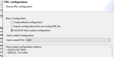

hemanttiwari199
thankyou for the inputs. I have made the changes according your suggestion.
Just need to confirm below points:
In the above image I am getting two option for Hard-coded RCW (0x8C) or (0x8F). Which one I have to select for my T2081 custom board?
In T2080RM, I have selected below hardcore option 0_100110x (where x is denoted by 0). Here the frequency of both sysclk and ddrclk is 66.66Mhz where in the tool (refer above image) frequency are different. Can you clear the confusion? What frequency I have to select for proper testing?
26,240 Views
ufedor
PBL Tool is out-of-date.
Please refer to the RM.
