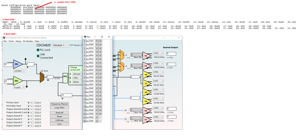

Another try was made(Set Serdes1 PLL2 to 125M, replace the original 100M):
1. In RCW, configure Serdes1 PLL2 125MHz.
2. In u-boot, configure registers of CDCM6208 to output 'Serdes1 PLL2' reference clock 125MHz. Measured and confirmed it really changed to 125MHz.
But we got same result.
In u-boot print info, 'ORIG' means the original reg values of 6208, 'WRITE' means reg values to be write, 'AFTER' means reg values readback after the write.
1,667 Views
