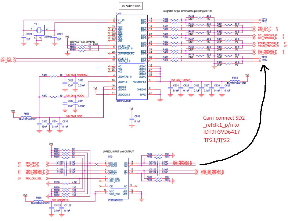

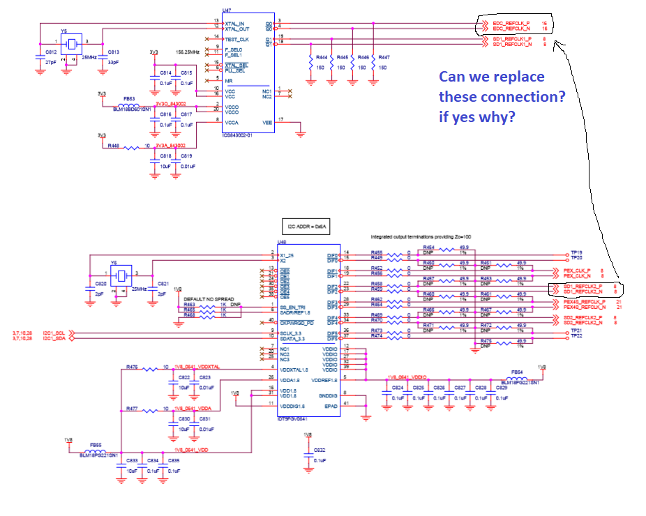

Currently i am working on the device is based t2080 processor.
In the design i am only using one Ethernet phy i.e. RTL8211E-VB.
As i am not using 10G EDC PHY CS4315, can i connect the SD1_REFCLK2 and SD1_REFCLK2 to U47 ICS843002-01? If yes, then why it is not connected in the reference design?
To understand better, i am enclosing the image for the same.
Waiting for your reply,
Hemant

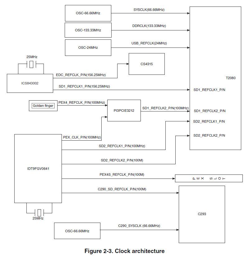

ufedor
Please refer to the following picture:
to realize that SD1_REFCLK1_P/N is 156.25MHz and SD1_REFCLK2_P/N is 100MHz

hemanttiwari199
In the image that you have shared above show SD2_REFCLK1_P/N AND SD2_REFCLK2_P/N are coming from IDT9FGV0641 but in the reference design SD2_REFCLK2_P/N is coming out from IDT9FGV0641 while SD1_REFCLK2_P/N is coming from ICS859S0212I?
If i connect both SD2_REFCLK1_P/N AND SD2_REFCLK2_P/N to IDT9FGV0641, is it going to work?
As i can see in the schematic that to diff. pair are free in IDT9FGV0641?
Waiting for your reply!!

hemanttiwari199
I am not using any kind of the PCIe connector in my design,
and according to picture shared by you both  SD2_REFCLK1_P/N and SD2_REFCLK2_P/N both having frequency of 100MHz.
my question is whether i can connect both the SD2_REFCLK1_P/N and SD2_REFCLK2_P to IDT9FGV0641 while eliminating the need of ICS859S0212I IC ?
Attaching the image for your reference?
Hemant

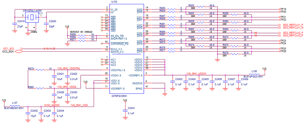

hemanttiwari199
Please ignore the above shared image as it was wrong.

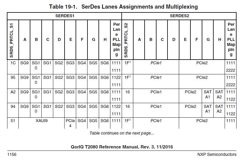

ufedor
SerDes Protocols:
etc....

ufedor
T2080RDB supports only SRDS_PRTCL_S1=0x66 and SRDS_PRTCL_S2=0x15.
Are the same used in your design?

hemanttiwari199
Showing the proposed clocking diagram. Please check and let me know what you think?
8,701 Views
hemanttiwari199
Attaching the final proposed clocking diagram.
