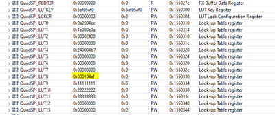

I am encountering an issue with the QSPI LUT table registers. When I first write values to LUT table registers 0x1550330 (LUT8) and 0x1550334 (LUT9), they are written correctly as expected. However, after writing values to LUT table registers 0x1550338 (LUT10) and 0x155033C (LUT11), the top byte of the value previously written to register 0x1550330 resets itself to 0x00.
For example:
  • After I write values to registers 0x1550338 and 0x155033C, the value in register 0x1550330 changes, and the top byte resets to 0x000104af.
    The above are Peripheral view. & here is the memory view:LutMemoryMap.PNG
I have ensured the QSPI LUT key (LUTKEY) is correctly set, and the LUT table is unlocked before writing to these registers.

Checked LS1046A Freeway Board | NXP Semiconductors, with MT25QU512 on board.
The drivers works well.
Have you check if the same commands in different LUTs or different command in the LUT8-11?
1,243 Views
June_Lu
Checked the errata no such limitation.
Would you let me know what's you QSPI Flash Chips part number? How do you connect them? The other LUT commands ever work correctly?
