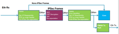

  We have encountered an issue with IPSec. When using IPSec to receive downlink packets, after a period of time, the core layer cannot receive the packets.
We are attempting to debug this issue
I conducted the following checks (before and after the problem occurred, the rate of downlink packet filling remained unchanged)
1. Check if there are no data packets on the network port. Through packet capture inspection, it was found that the network port can receive downstream ESP packets

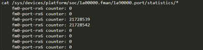

2. Check the rx port of fman and find that the number of counter values increasing within 1 second before and after the problem is similar

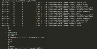

3. Check the esp interrupt and performance monitor registers, and after checking the issue, the decryption times in 1 second have increased by about the same amount

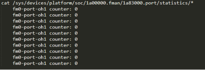

4. I tried to check the FMan offline port, but the counter was always 0 and there was no valid information available
May I ask if there is any other information that can help us debug the issue of the core layer not receiving packets?

3. Can you see 'ob_bytes_encrypted' and 'ib_bytes_decrypted' number increase when in problematic setup?

3.Only tested the downlink, ib_ bytes_ decrypted number consistently increase when in problematic setup
