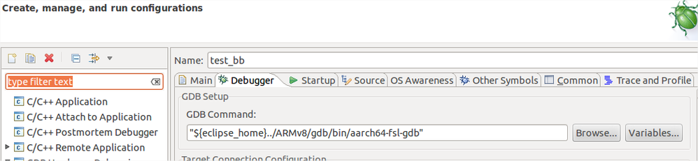

I am trying to connect to the LS1043ARDB board using CW_ARMv8 v11.2.0 or v11.1.1 and the CodeWarrior TAP in Ubuntu 14.04. I get the following error:
Error in final launch sequence
Failed to execute MI command:
-interpreter-exec console "source /home/davisg/CW_ARMv8/.metadata/.plugins/com.freescale.debug.tcc/target_init5898642085241188885.gdb"
Error message from debugger back end:
/home/davisg/CW_ARMv8/.metadata/.plugins/com.freescale.debug.tcc/target_init5898642085241188885.gdb:478: Error in sourced command file:\nRemote 'g' packet reply is too long: 310500000000000000000000000000002cdbe77fc0ffffff64ef5900c0ffffff2000000000000000100000000000000000fad8563f00000080e0e77fc0ffffff80ad9400c0ffffff30bd9300c0ffffffccf4ffff0000000004000000000000000000000000000000000000000000000008000000000000000000002827f01a00003a1a00c0ffffffb0d1297d7f00000030fbd3e57f00000000809300c0ffffff8c459400c0ffffff08459400c0ffffff6be39a00c0ffffff010000000000000050398300c0ffffffd0386c00c0ffffff0030a6800000000030120800c0ffffff00000080400000000000000000000000000000000000000000000000000000000000000000000000cd03000070fcd3e57f00000020bf9300c0ffffff00805e774000000064710800c0ffffff848c6b00c0ffffff0cc00800c0ffffff45010060c5000020cd010000000000560000005a0000000213630003001000000000000000000000000000000000000000000000000000000000000000000000000000000000000000000000000000000000000000000000000000000000000000000000000000000000000000000000000000000000000000000000000000000000000000000000000000000000000000000000000000000000000006513010
Not sure how to resolve this. This all works in the Windows version of CW_ARMv8 v11.1.1 but I am trying to switch to Linux version to make u-boot debug easier.

I think I find out the root cause. Are you using the fsl_eclipse.sh script to open CW on the linux side? I can reproduce this error, only if I'm using the eclipse executable from CW_NetApps_v2016.01_160115/CW_ARMv8/eclipse$ ./eclipse (but this is not correct).
The correct way to open CW is to use the fsl_eclipse.sh -> CW_NetApps_v2016.01_160115/CW_ARMv8$ ./fsl_eclipse.sh
I cannot advise you to update manually the project (can be also and other differences), but if you want to make a try you'll need the update the .launch file from your project:
replace next line
<stringAttribute key="org.eclipse.cdt.dsf.gdb.DEBUG_NAME" value="gdb"/>
with
<stringAttribute key="org.eclipse.cdt.dsf.gdb.DEBUG_NAME" value="&quot;${eclipse_home}../ARMv8/gdb/bin/aarch64-fsl-gdb&quot;"/>
Thank you,
Marius

Fixed. Had to change from "gdb" command (default) to "/opt/Freescale/CW4NET_v2015.08/CW_ARMv8/ARMv8/gdb/bin/aarch64-fsl-gdb.bin" in the debug configuration

This is strange, the default GDB Command wasn't something like bellow?
1,330件の閲覧回数
Davisg
No, the default was "gdb". How do I change the default so i do not have to modify each debug configuration?
