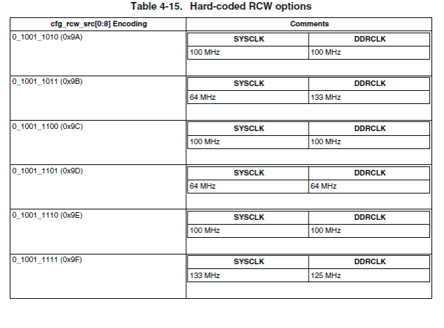

You likely have no RCW in flash. This is a classic chicken and egg scenario with the processors. They need a valid RCW to come out of reset but if you don't have a valid RCW you can't program flash.
With a blank flash, you still need to provide an RCW. This could be done through pre-programmed flash, forcing a valid RCW through JTAG, or changing the cfg_rcw_src pins to force the use of a hard coded RCW.
Please try to change your pin strappings to a valid hard coded RCW (I'd suggest 0x9A if your sysclk = 100MHz) and try again.
Remember to change the pin strapping back to what you had, after you program the RCW, in order to enable the processor to come out of reset using your intended RCW.

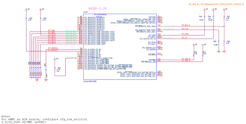

We are experiencing a similar issue as described in this thread. We have a hardwired RCW CFG setting as shown below, for booting from eMMC.
RCW source hard strapping on target board
So my question is how do we program a virgin, un-programmed board using JTAG tools, if there is no RCW to begin with? Is it possible to override the RCW strapping settings as described below?

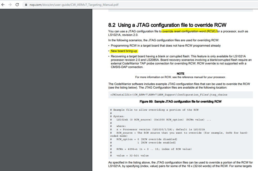

Please try using RCW override option from CW (you can find info into Targeting manual available in \ARMv7\Help\PDF\) The problem might be because of missing/incorrect RCW on your board.

Please refer to AN5184_Programing_SD_MMC_ARMv7 , chapter 4.1. This section will describes the steps for using RCW override feature from CW.

If the RCW is missing from the board, there is no way to read it.
Basically in JTAG configuration file, you have to set at least the RCW_source as below:
LS1021A (0 0x9b) (0x1000 1)
If the PLL settings on your board fit with the value of hardcoded RCW use as RCW_source, then you will be able to take control over the board and restore the RCW into flash.
Adrian

CW jtag file you are trying to use is not correct. You can find jtag file under CW_ARMv7\ARMv7\ARM_Support\Configuration_Files\jtag_chains\. Also, as I said before you can use only
DAP
SAP2
If you are sure 0x9b hardcoded value fit your board settings.
Adrian
