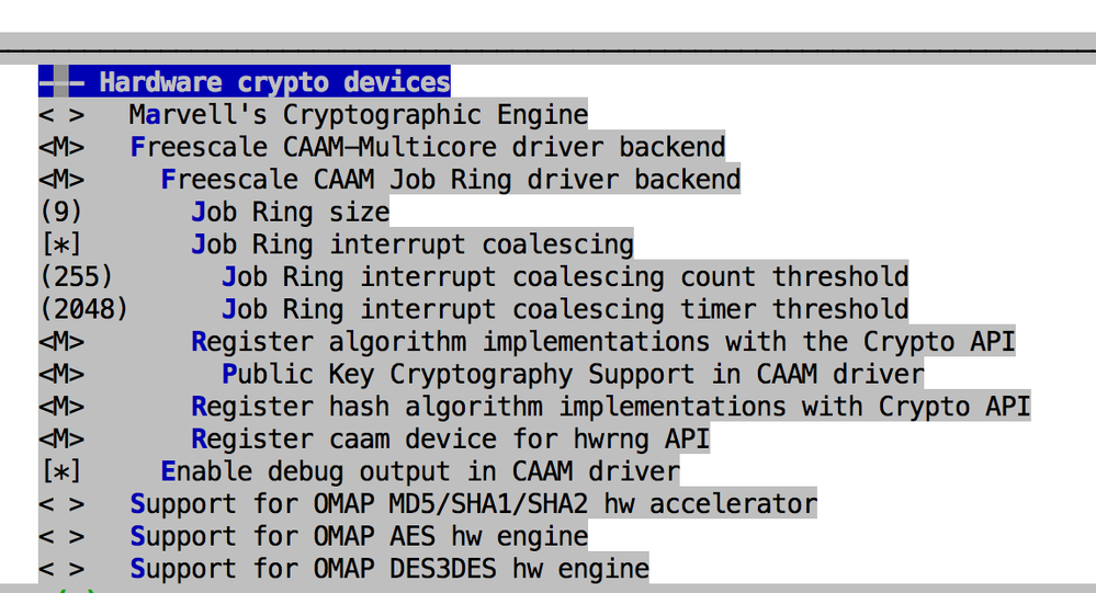

Seems that is a bug of SDK? We didn't enable it in the kernel, please refer below picture shows
Also, I checked the CAAM driver folder Kconfig file, seems it is fine as we absolutely not select iMX series CPU, but no idea why it was enabling
config CRYPTO_DEV_FSL_CAAM_IMX
        def_bool SOC_IMX6 || SOC_IMX7D
        depends on CRYPTO_DEV_FSL_CAAM
config CRYPTO_DEV_FSL_CAAM_LE
        def_bool (CRYPTO_DEV_FSL_CAAM_IMX || SOC_LS1021A) && !ARCH_LAYERSCAPE
I will disable it and compare config file which you attached one and do a test now, will keep you update

yipingwang
Hello Yuqian,
Please also disable SOC_IMX6 in your Kernel configuration file.
Yiping

yuqianli
Hi Yiping,
Thanks for your support, Now I got it working, will test the performance :smileyhappy:
root@OpenWrt:/# dmesg |grep caam
[ 49.746357] caam_jr 1710000.jr: caam_read: start reading at buffer 0, idx 0
[ 49.746711] caam 1700000.crypto: fsl,sec-v5.0 algorithms registered in /proc/crypto
