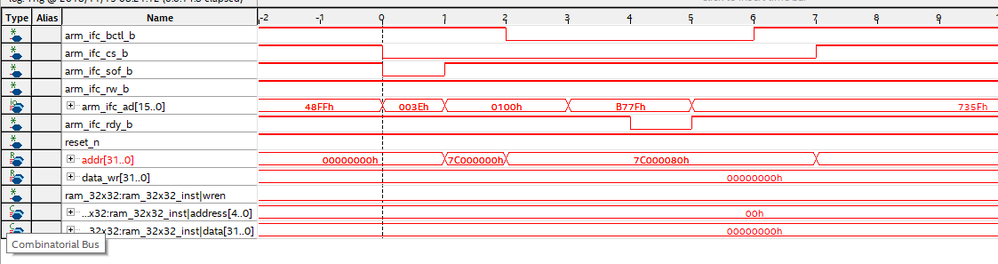

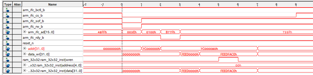

cpyocum
Here are the signal taps of the write and read. They both appear to be within spec, but the read triggers a synchronous external abort in Linux. This is the write:
And this is the read:
The write includes the decoded data inside the FPGA, but the read doesn't. However, you can see that it's outputting the same values to the AD lines as came in during the write.
