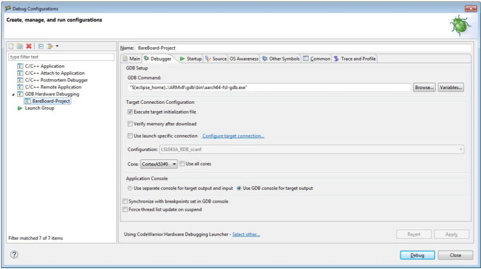

Anyway, I finally found the setting to disable target initialization when launching debug.  When creating a barebone u-boot project.. Under GDB setting/Debugger tab, uncheck "Execute target initialization file"
Also if it can help others, when using NXP's LSDK to generate u-boot code, don't load the EFL file in CW as it doesn't contains debug symbol.  Use the file "u-boot" without extension.  It's about 6-7MB in size.  This one is compatible with CW debugger session.  With this file, you will be able to tell CW to break execution at a particular function (_start) for example:
In my case, ATF was loading u-boot properly in RAM, so I unchecked "Load image" in the startup tab:
