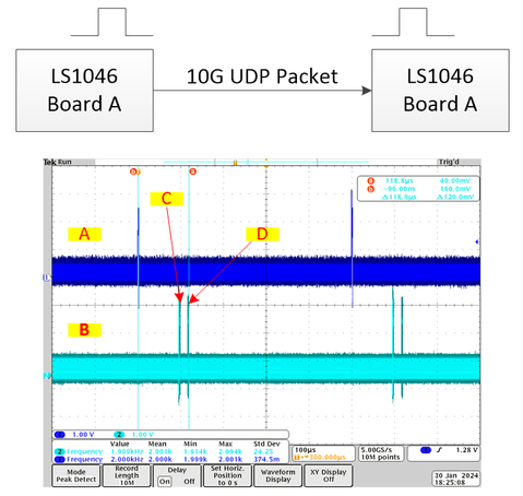

I am using the LS1046A custom board.
I am using QorIQ-SDK-v2.0-1703 (k4.1.35-rt41) by porting it.
We conducted an experiment as follows.
1. Connected from board A to board B with an optical cable to 10G (fm1-mac9).
2. There are 4 cores, but numbers 1 to 3 were isolated.
3. Transmission and reception threads are assigned to the isolation core.
4. The QMAN interrupt is assigned to the isolation core.
5. A SOCK_DGRAM socket was created and a UDP packet of (42+28) bytes was sent from A to B.
6. Using a timer, 1 packet was transmitted every 500us.
7. The gpio TP was toggled in sendto on board A, and the gpio TP was toggled in recvfrom on board B.
8. The gap between TPs of A and B was measured using an oscilloscope.
The results measured an average of 104us and a maximum of 136us.
I expect measurements of less than 125 microseconds with a consistent interval of time.
Looking for ways to reduce spacing and jitter.
Any ideas are great, so if you have a method, please let me know.

Gyosun
Hi Sebastian,
I am not familiar with measuring tools.
I tested it using two boards and measured it using GPIO TP in sendto & recvfrom.
I have measured cumulatively using an oscilloscope.
Section description
A: Board A sendto point
B: Board B recvfrom point
C: Average packet transmission time from A to B
Packet transmission jitter from A to B
We are considering two things about what we want.
1. Sometimes, like section D, it takes longer than the average time.
    We want to eliminate this time.
2. How to reduce section C
Kernel options, sysctl, etc. Anything is fine.
Thank you for your proactive response.
Thank you.
Gyosun.

Gyosun
Hi Sebastian,
I debugged for a long time.
The cause was found in the dpaa_eth_refill_bpools function in the drivers/net/ethernet/freescale/sdk_dpaa/dpaa_eth_sg.c file.
When THRESHOLD was exceeded, jitter was occurring as it was reallocated up to MAX.
So, I increased the reallocation buffer and modified the value to allocate only one as follows.
CONFIG_FSL_DPAA_ETH_MAX_BUF_COUNT=32768
CONFIG_FSL_DPAA_ETH_REFILL_THRESHOLD=32767
Then the jitter disappeared and reception became stable.
Will there be any problem if I modify it as above?
Please let me know if there is any way to improve further.
Thank you.
Gyosun.
