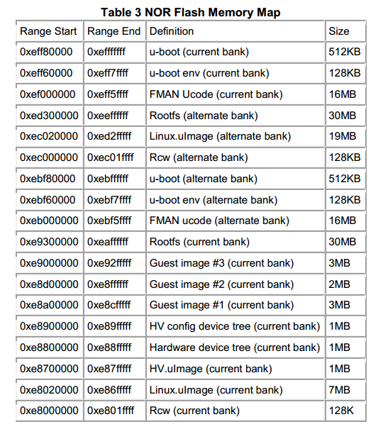

Please refer to the P2040 QorIQ Integrated Multicore Communication Processor Family Reference Manual, 13.3.6 Options register n layout for GPCM Mode (eLBC_ORgn) - after reset CS0 is valid BR0[V]=1 and OR0[AM]=0 - i.e. the whole eLBC 32-bit address space will be "filled" by copies of the 128MB NOR Flash connected to CS0.
4 kB of the uppermost "copy" of the boot device will be exposed in the Boot Page (RM, 4.3.3 Boot Space Translation), so the core will be able to fetch and execute its first instructio from address 0x0_FFFF_FFFC.
1,031 Views
ufedor
Please note that NOR Flash is directly mapped into the processor's address space as a whole, so it is possible to execute U-Boot code from the NOR Flash directly (in contrary to NAND Flash, which is a block device, thus U-Boot code has to be read from NAND to CPC SRAM and executed from there).
1) according to  P2041RDB NOR flash(current Bank) memory map RCW is starts at 0x0 and U-Boot is located end of the NOR flash i.e. "0xeff80000".
How PBL knows U-Boot location after RCW read and write configuration? I mean how processor 4KB bootspace will be mapped to U-boot location?
2) When board booted to u-boot console.. NOR Flash memory map will be E8000000-EFFFFFFF... But  bootspace memory map is FFFFF000-FFFFFFFF(4kb). If Bootspace code execution happening from NOR flash it self.. How NOR flash will be remapped to "E8000000-EFFFFFFF"?
