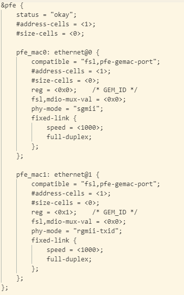

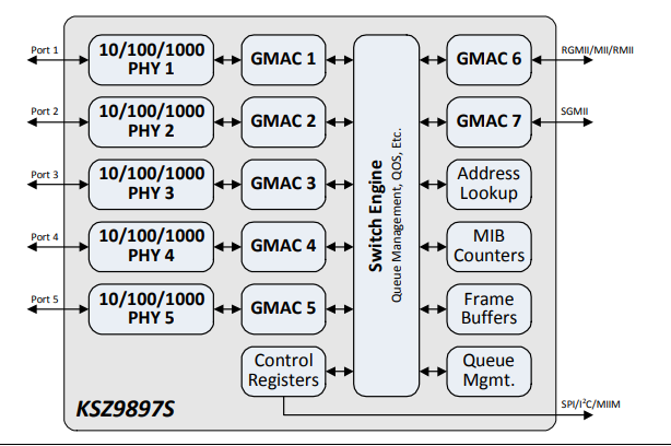

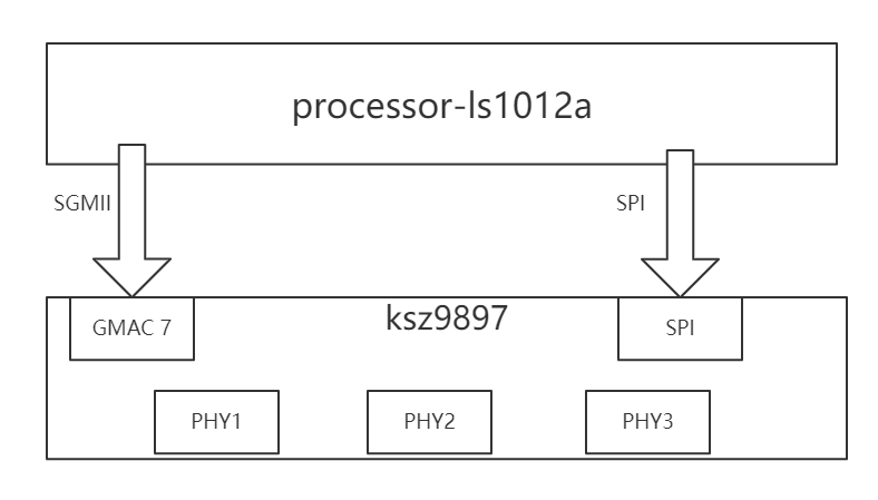

I am using ls1012a on my hardware, also I am using ksz9477 ethernet switch connecting to PFE
                                                                        Figure 1: KSZ9897S
Because ksz9897 doesn't support MDIO (it supports actually, but we chose SPI interface for better performance), so I am using the SPI instead of MDIO. see below.

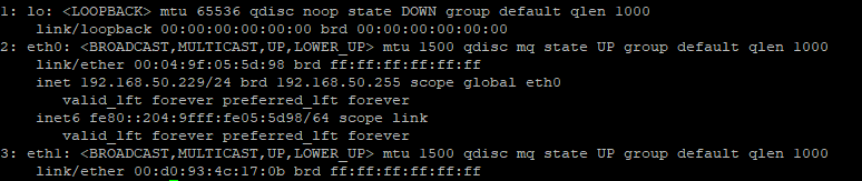

I can see eth0 and eth1 when the board is powered onAlso, I can configure eth0 with static ip. But I cannot ping external devices at all. I assume the problem happens on the connection of MAC and PHY. The driver spi-fsl-dspi.ko is not used by any other modules. I think the problem is caused by my device tree configuration.
I configured my device tree as below:
                                                                                        Figure 3: PFE node
                                                                             Figure 4: SPI node
 port@6   (i.eGMAC7) in the device tree is used as the MAC port connecting to PFE via SGMII.
Also, I can see both eth0 and eth1, but I am only using eth0 and I can configure the eth0 with static ip.
But I cannot ping external devices at all. Is there any problem with my device tree?
Anyone who can help? Thank you

NXP SDK uses MDIO. It looks like that SPI driver was test tested for this task.
Test your board using MDIO instead of SPI.
Usually performance does not produce limitations for MDIO using.

This KSZ9897S switch supports MIIM (MDIO).
See the KSZ9897S Datasheet.
See the LED4_1, LED3_1 setting.
Use this interface for connection.

Sorry, I think I put the wrong reason why we choose SPI instead of MDIO, the reason is, in the datesheet, it shows that SPI provicdes the highest performance, see below.
The dspi node is probed successfully, I can see information about dspi in dmesg output. But there is no information about the sub node of dspi which is the KSZ9897.  It seems that the switch node is not probed at all.
