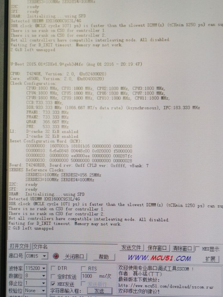

We have made a board with a T4240. On the board, we installed a DDR3_ SODIMM slot, and we used one  4GB DDR3L-1600 CL9  204-Pin  SODIMM  ( see figure 2 ).  But when we do DDR initialization, the serial communication interface shows a message"2 GB left unmapped"(See figure 1).   Why?

ufedor
Described behaviour is normal.
U-Boot maps only 2 GB of SDRAM. Linux will use the whole available SDRAM.

zhangkun2015
Thank you for your reply.
Then What's the meaning of "waiting for D_INIT time out. Memory may not work."? Why the DDR3 module  can't work?
5,178 Views
ufedor
The DDR clock (933.334 MHz) is too fast for the SDRAM module.
It is needed to lower the DDR clock by modifing the RCW.

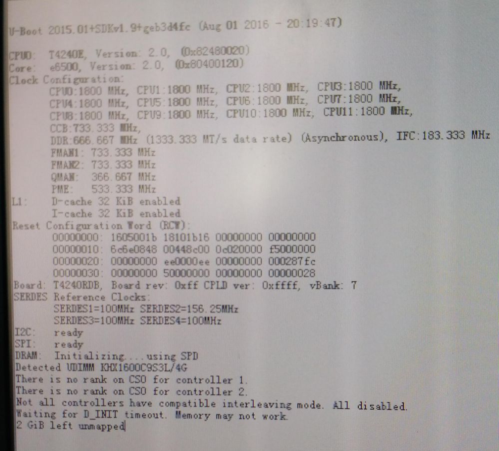

zhangkun2015
OK, I have modified the RCW  as your suggestion,and the DDR clock has been reduced to 666.667MHz, But the DDR3 still can't work.mmexport1486633871786.jpg

ufedor
Quality of the provided "screenshots" is not good.
Please send logs as text files.

zhangkun2015
Thanks for your suggestion, I change the "screenshot" figure.
The message is " Waiting for D_INIT time out.  Memory may not work"

zhangkun2015
ok, AS the below shows.
U-Boot 2015.01+SDKv1.9+geb3d4fc (Aug 01 2016 - 20:19:47)
CPU0: T4240E, Version: 2.0, (0x82480020)
Core: e6500, Version: 2.0, (0x80400120)
Clock Configuration:
CPU0:1800 MHz, CPU1:1800 MHz, CPU2:1800 MHz, CPU3:1800 MHz,
CPU4:1800 MHz, CPU5:1800 MHz, CPU6:1800 MHz, CPU7:1800 MHz,
CPU8:1800 MHz, CPU9:1800 MHz, CPU10:1800 MHz, CPU11:1800 MHz,
CCB:733.333 MHz,
DDR:666.667 MHz (1333.333 MT/s data rate) (Asynchronous), IFC:183.333 MHz
FMAN1: 733.333 MHz
FMAN2: 733.333 MHz
QMAN: 366.667 MHz
PME: 533.333 MHz
L1: D-cache 32 KiB enabled
I-cache 32 KiB enabled
Reset Configuration Word (RCW):
00000000: 1605001b 18101b16 00000000 00000000
00000010: 6c6e0848 00448c00 0c020000 f5000000
00000020: 00000000 ee0000ee 00000000 000287fc
00000030: 00000000 50000000 00000000 00000028
Board: T4240RDB, Board rev: 0xff CPLD ver: 0xffff, vBank: 7
SERDES Reference Clocks:
SERDES1=100MHz SERDES2=156.25MHz
SERDES3=100MHz SERDES4=100MHz
I2C: ready
SPI: ready
DRAM: Initializing....using SPD
Detected UDIMM KHX1600C9S3L/4G
There is no rank on CS0 for controller 1.
There is no rank on CS0 for controller 2.
Not all controllers have compatible interleaving mode. All disabled.
Waiting for D_INIT timeout. Memory may not work.
2 GiB left unmapped

ufedor
1) How many boards were tested?
2) Have you tried another SDRAM modules (for example used on the original T4240RDB)?
3) Why on the photo HX316LS9IB/4 is shown, but U-Boot prints KHX1600C9S3L/4G?
