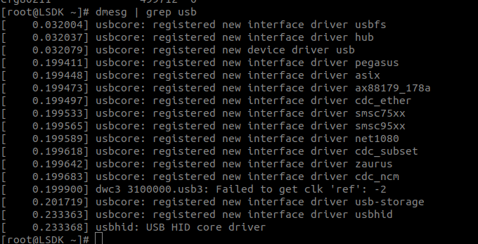

So once I loaded modprobe g_serial
it thrown me error [    0.200027] dwc3 3100000.usb3: Failed to get clk 'ref': -2
Can anyone help?

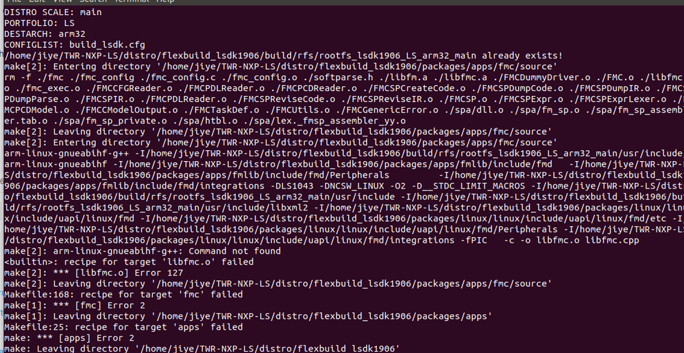

(1) I tried your command then I got this
I do not know what this command use for if you can tell me a bit more
(2) this is my console log:

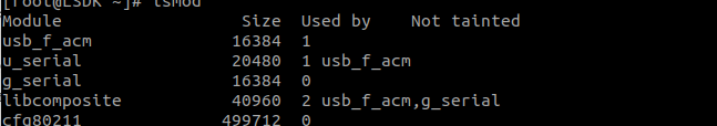

modprobe g_serial
if you see Failed to get clk ref:-2 because I need to change this in the ls1021atwr.dtb file?
but I do not have the /boot directory when I use flex-builder -i mkrfs -r buildroot:tiny -a arm32   I manually created the folder then copied and pasted the dtb file into it but it did not work
How to add modprobe g_serial upon start up since I do not have /etc/modules file

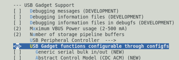

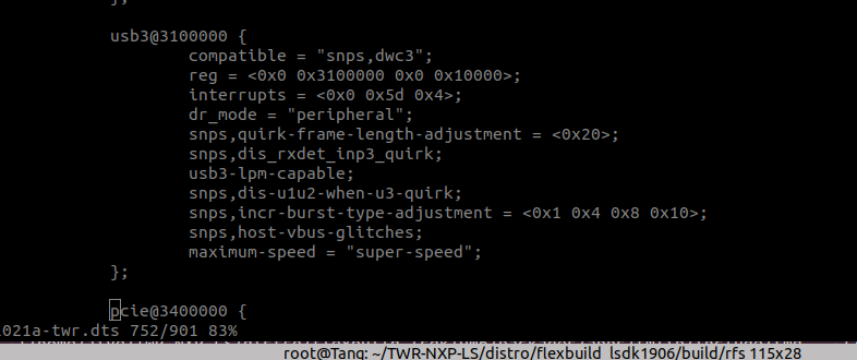

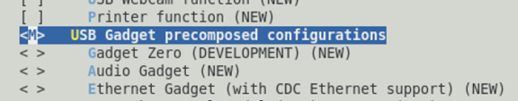

Please refer to the following procedure
     Update kernel menuconfig
Device tree
Device Tree update, change property dr_mode’s data from “host” to “peripheral”, add property maximum-speed = “super-speed”; as below
Build whole Linux kernel, below KO will be compiled:
LD [M] drivers/usb/gadget/function/usb_f_acm.ko
LD [M] drivers/usb/gadget/function/u_serial.ko
LD [M] drivers/usb/gadget/function/usb_f_obex.ko
LD [M] drivers/usb/gadget/function/usb_f_serial.ko
LD [M] drivers/usb/gadget/legacy/g_serial.ko
