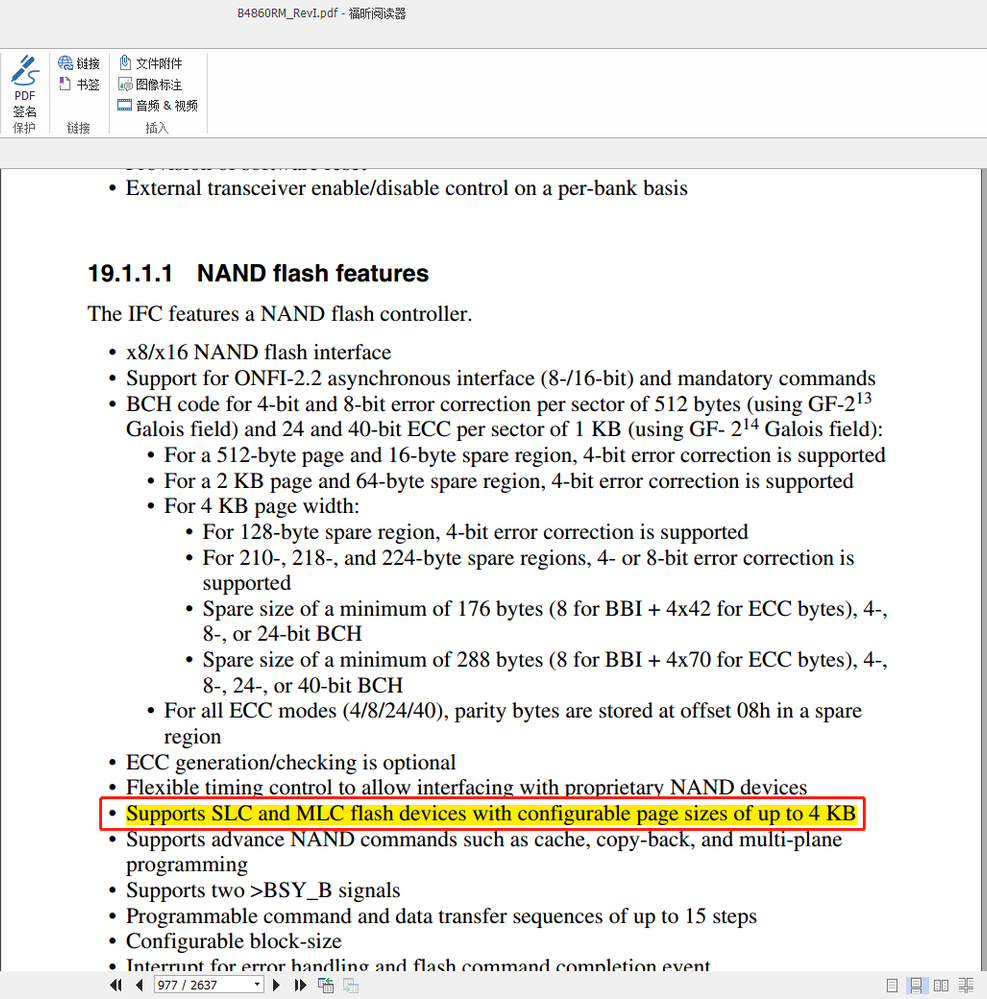

freescale-tomzh
I've tried this configuration and it still doesn't work.
And I found this limitation in the B4860RM_RevI. Can it confirm that this 8kb-pagesize chip is not supported?
3,420 Views
yipingwang
This is the limitation to support 8K page size NAND flash.
