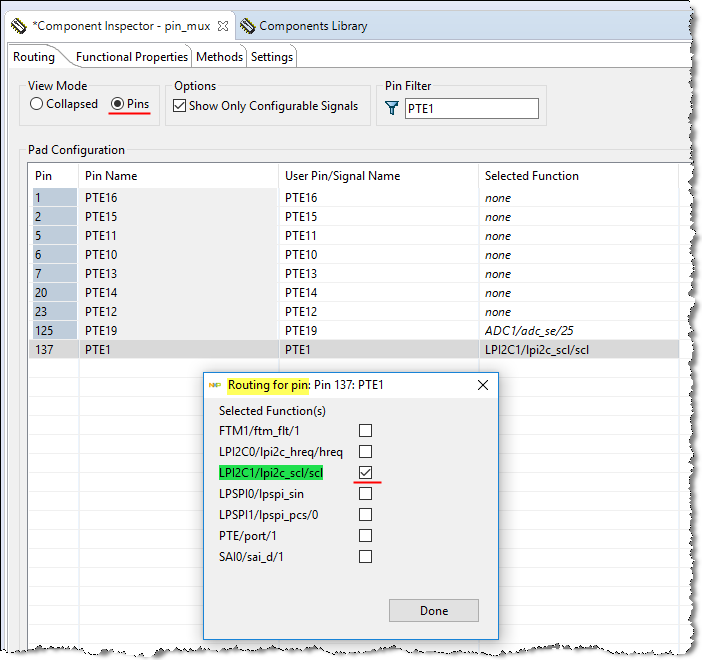

I accidentally changed the state of some signals from "no pin routed" to a specific pin.
I am able able to assign another pin (among a list of allowable pins) to these signals but am unable to change any back to "no pin routed".
How do I change the pin assignment of a signal back to "no pin routed"?
See attached with picture of this.
2,868 Views
Robin_Shen
Hi hw,
You can select "Pins" in View Mode, and uncheck the selected function.
Then it will  back to "no pin routed".
Robin

huang_hw
Thanks Robin. It worked like a charm. :smileyhappy:
