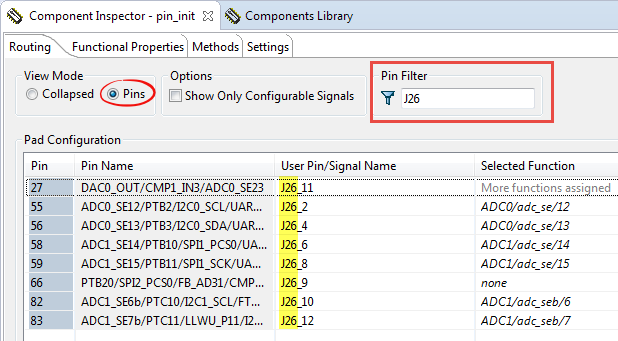

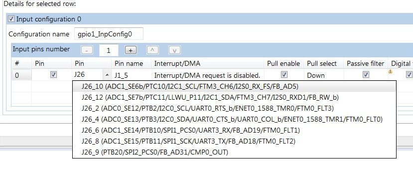

connector on FRDM-K64Z schematics drawing? I only found Micro USB
On KSDK1.2 component fsl_gpio it exist as you can see from my screen capture
1,042 Views
Jorge_Gonzalez
Hello shaul dorf:
I think the developers overlooked this for FRDM-K64F. The header is now labeled J4.
I reported this already, but in the meantime the fix is easy. Just open the PinSettings component and go to the Pins view mode. Then you can filter by J26 and change the User Pin/Signal Name:
