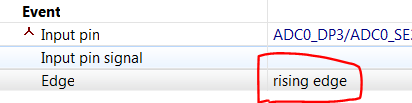

I did the same as you said, but it seems that the edge can not be changed during the excutation of code. event.PNG
and in my code, I use the function :
Cap1_SelectCaptureEdge(Cap1DeviceData,EDGE_BOTH);  or Cap1_SelectCaptureEdge(Cap1DeviceData,EDGE_FALLING);
to change the property of Edge.
All the values I got are time of the apprance of rising edge.

I have a signal of 200Hz and 40% duty cycle, TimerUnit counter frequency is 375kHz.
And the result of Cap_E[4] is : 1870,  3745, 5620, 7495. It has a difference of 1875 between two values, 375kHz/1875 = 200Hz.
That is to say, 1870,  3745, 5620, 7495 are the time of rising edge.

I have answered the issue at the discussion thread Re: Capture_LDD SelectCaptureEdge
There is a problem width the update of the channel status and control register (TPMx_CnSC).
