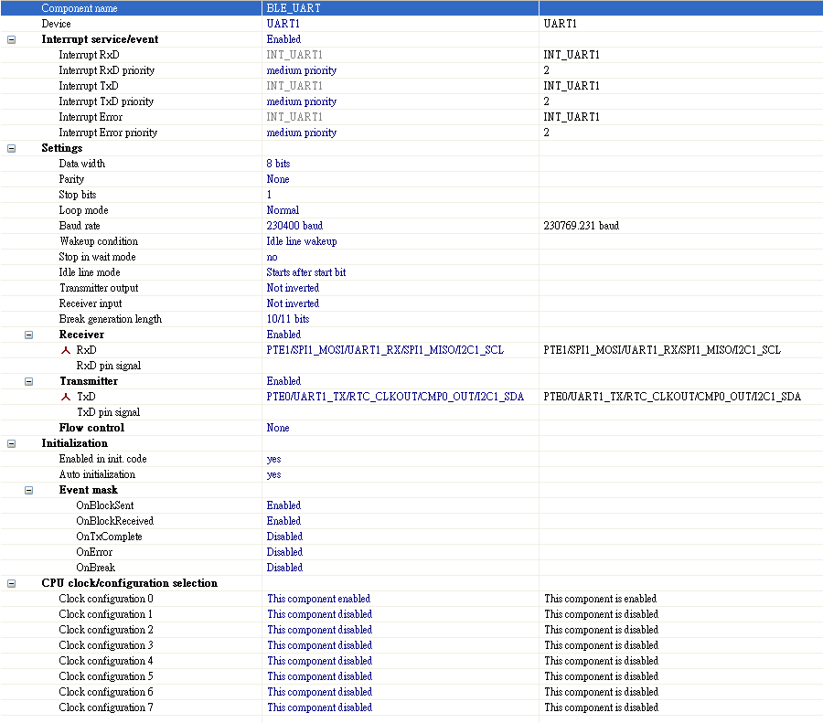

I have encountered a problem that when I use the UART1 on KL25 Freedom Board on Pin18, Pin20 of connector J2 for Tx,Rx of UART1, I found the output Baud Rate is half what I set in ProcessExpert Component. For example, if I need 115200, I need to set it to 230400 in the Serial_LDD.
The CPU clock setting and the Serial_LDD settings are attached here.
I have checked it with oscilloscope and proved it by PC terminal. I am using CodeWarrior for MCU version 10.3
I hope it's helpful to be fixed in the coming version of PE.

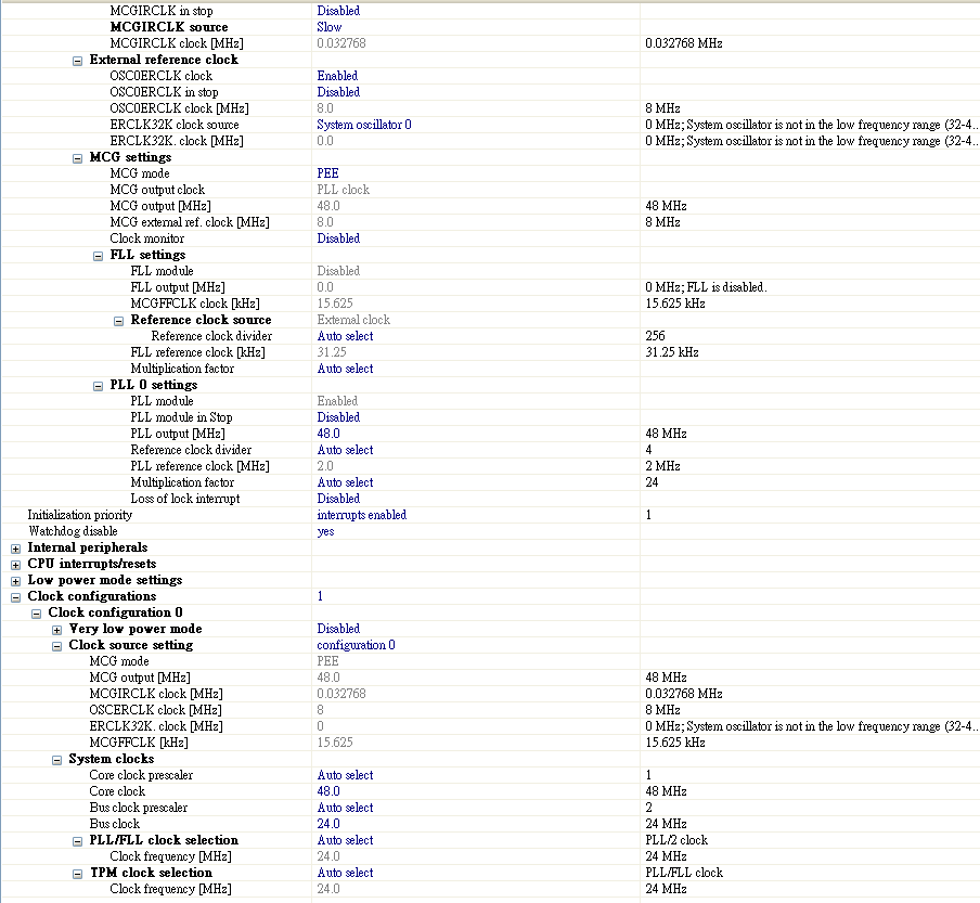

Yes, I have found the same problem, and I have filed a ticket to get it fixed.
The issue is that Processor Expert thinks that the bus is being clocked at 48MHz. It is not taking into account that the bus clock divider on L series is dividing down the Core clock, NOT the MCGOUTCLK that would be used on Kinetis K series.

I developed an application using UART1 on PTC4 And PTC3 pins.The micro controller has a crystal 8MHz and the PLL as PEE ( with Processor Expert ) at 96MHz with CoreClock at 48MHz and BusClock at 24MHz.
When i set baud rate 9600 for UART1 I found the output Baud Rate is half (4800) what I set in ProcessExpert Component.
Here my core clock to bus clock ratio is 1/2 and because of that my baud rate i (9600*(1/2))=4800.
If my core clock and bus clock ratio get is same it is get sets at 9600.
But if my core clock and bus clock ratio is changed what exact equation need to be apply?

Yes, this is a problem of MCU10.3 (see Be Aware of the Baud Problem | MCU on Eclipse). I recommend that you verify/change the prescaler settings as outlined in above post, or switch to a later version of CodeWarrior. MCU V10.6 just came out.

we are aware of this issue. It will be fixed in the upcoming update of CW V10.3. The problem is in our model, so the requested value is necessary multiply by two to get the correct output timing.
We are sorry for inconvenience.
