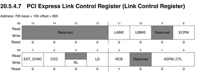

We are working on T2080  PCIe . According to QorIQ_T2080_Reference_Manual(PgNo : 1545) we want to change the Common clock configuration(CCC) bit value in Link Control Register.
Can I get  more information on how to configure it in U-boot level?

You can change the link control register in drivers/pci/fsl_pci_init.c
for ex as below to change cc to 1:
pci_lcr = pcie_cap_pos + 0x10;
temp32 |= 0x40;
pci_hose_write_config_dword(hose, dev, pci_lcr, temp32);

We have already changed as mentioned above but still couldn't configure to common clock.
We configured in the following path /drivers/pci/fsl_pci_init.c
void fsl_pci_init(struct pci_controller *hose, struct fsl_pci_info *pci_info)
#code
if (retrain_link_g)
temp32 = 0;
pci_hose_read_config_dword(hose, dev, pci_lcr, &temp32);
printf("pci_lcr: 0x%x\n", temp32);
temp32 |= 0x40;
printf("pci_lcr mk: 0x%x\n", temp32);
udelay(100000);
Are there any other modifications that are required.?
