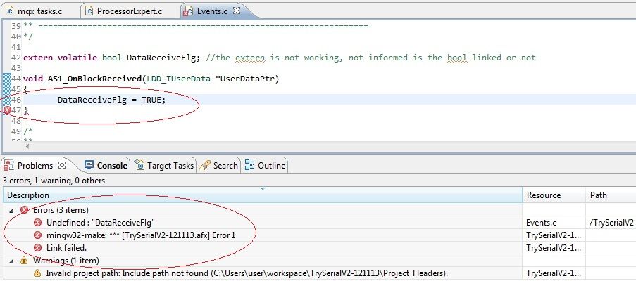

bondansuwandi
Hi Petr,
I have question regarding to the serial_LDD example in "Help on component: pop -up menu". I tried this example with MQX-lite and I got some error due to Link Failed between "extern volatile bool DataReceiveFlg;" in the event.c and "volatile bool DataReceiveFlg = FALSE;" in the mqx_tasks.c. when I removed the "extern", the error solved, but I am not sure both DataReceiveFlg are linked or not.
Do you have any solution for this error?
Bondan
