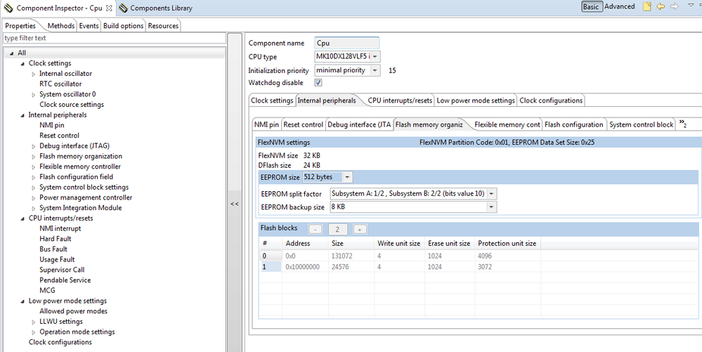

I am using PE with KDS 3.0.0 with MK10DX128VLF5 processor and i am trying to get the FlexNVM to work but having problem with the partition.
i've setup the memory organization as per the attached screenshot.
when i call the Cpu_SetFlexNVMPartition(), it returned ERR_FAILED, because FSTAT register value is 0xa0. why failed? Thank you.

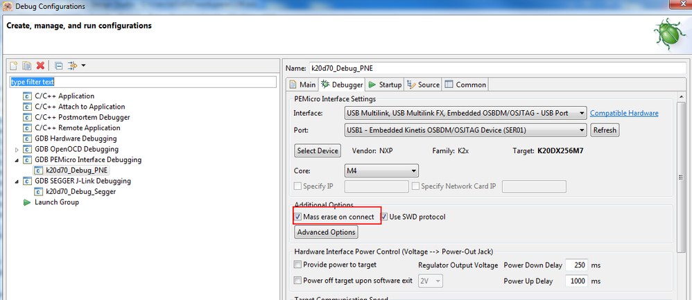

I don't know the details of your application but the issue can be caused by existing partition code that is programmed on your device. The partition code can be erased by the Erase All Blocks Command only, see the detailed description in the Program Partition Code chapter in the MK10DX128 reference manual. You can also configure the debugger to execute this erase operation. For example the PEMicro debugger provides "Mass Erase on connect" options or you can use the J-link Commander to execute the mass erase operation and programming of the device.

What value is returned by the Cpu_GetFlexNVMPartitionCode() method? You must receive FLEX_NVM_NOT_PARTITIONED otherwise the partitioning is not possible.
Please, make sure that the mass erase operation is processed (and the debugger or any tool does not process partitioning). If you just erase flash the previous partitioning is not impacted.

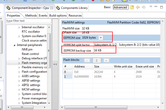

Hello Marek,
I use the TWR0K20D72M(  k20dx256vll7 ) board, on KDS 3.0 +PE,
use the code you provide , configure the EEPROM size to 1K, the
EEPROM backup size to 16k, the other place as default .
While when i run the function of
the register of FTFL_FSTAT->ACCERR is 1:Access error detected .
And when i run the function of    PartitionCode = Cpu_GetFlexNVMPartitionCode(); it return FLEX_NVM_NOT_PARTITIONED .
I use the PE debug mode , and select the "Mass erase on connect":

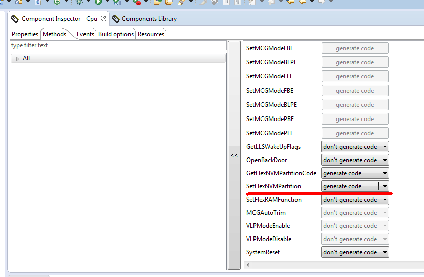

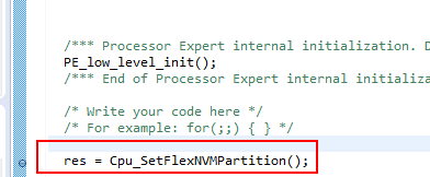

First, the function of "SetFlexNVMPartition" have been enabled.
Secondly, i call this function the same as Marek Neuzil's reply. when call the Cpu_SetFlexNVMPartition(), it returned ERR_FAILED.
