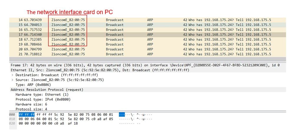

I'm practicing ethernet communication on frdm-k64f, my first step is to build the simple project with only ethernet communication. However, I can't get any ethernet packet after many trying. The project with simple ethernet I build is attached file, the receiving code is from "help on component" on Processor Expert.
The environment of this project is Kinetis Design Studio 3.0 and KSDK 1.x.  The hardware is FRDM-K64F.
The way I try to make ethernet packet receiving happen is to connect the ethernet directly to my PC via RJ45. I command PC to Ping the k64f via the network interface card, and network interface card broadcast the ARP request with Dest. addr. ff:ff:ff:ff:ff:ff, as shown in photo by wireshark. wireshark_ping.JPGI expect k64f should receive this ethernet packet for the "Dest. addr. ff:ff:ff:ff:ff:ff", but I can't get any packet receiving event in debug mode.

May I know if there is a specific reason to use Kinetis Design Studio? I strongly recommend you to switch to MCUXpresso IDE and make use of the SDK for the K64.
In the SDK, there is one example that sounds very similar of what you are trying to do. The example is called enet_txrx_transfer.
Best regards, Daniel.
