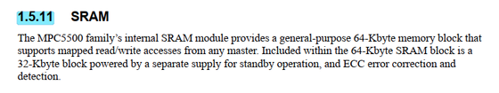

I develop software on MPC5566 microcontroller and I have doubt regarding SRAM zone protected with ECC mechanism.
Datasheet says in chapter 1.5.11 "The SRAM size is 128 KB. Included within the SRAM block is a 32-KB block powered by a separate supply for standby operation and ECC error correction and detection."
Is the entire SRAM is protected with ECC mechanism or just the first 32 KB ?

No, the whole SRAM is protected.
Looking to RM of different member, MPC5500 family - just a missing comma.
