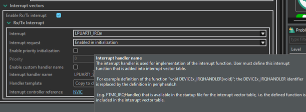

I'm developing a project based on the MCXA153VLH microprocessor.
It needs to receive data serially using the LPUART1 peripheral in interrupt mode.
Upon receiving data, a dedicated interrupt routine named Rs485Interrupt should be called.

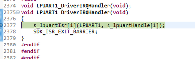

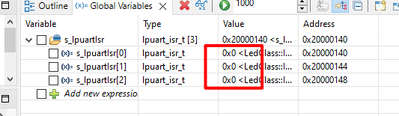

I've debugged the code, and the interrupt handler is called correctly,
but the s_lpuartIsr array is not initialized, and the program crashes.
Have you experienced a similar issue? How did you solve it?

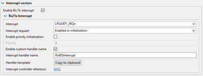

Thanks for your help, Habib_MS. I found the solution to the problem. It was because my interrupt handling routine was in a .cpp file.
Changing the file extension from .cpp to .c solved the issue.

Hello @_Ferrari_,
You need to redefine the IRQ, as explained in the tooltip that appears when you hover over the option:

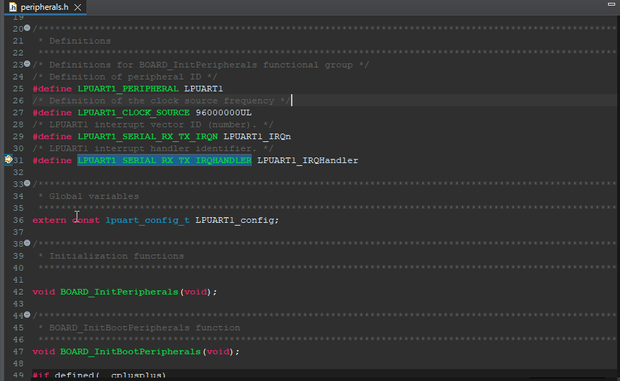

To help with this, you can use the name that you assign to the IRQ handler. for example, the default name "LPUART1_SERIAL_RX_TX_IRQHANDLER", which can be found in peripherals.h:
Additionally, I recommend see the SDK (version 25.6) example titled "lpuart_interrupt". It demonstrates how to properly configure an interrupt and provides a good reference for understanding how it works.
