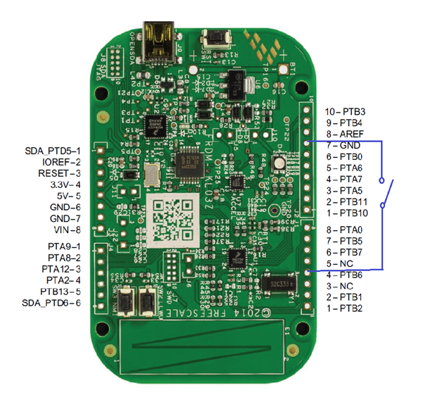

The CPU wake up is possible by the following ways:
- When you push the SW2 button the processor is woken and the green LED start blinking (5 times).
- When you short the pin PTB6 to ground 5 times (the pin is available on the 8 pin header connector – pin number 4; you can for example connect a button to the pin number 4 and ground) the processor is woken and the green LED start blinking (5 times).
- When selected RTC timeout expired (15 seconds) the processor is woken by the alarm interrupt and the green LED start blinking (5 times).

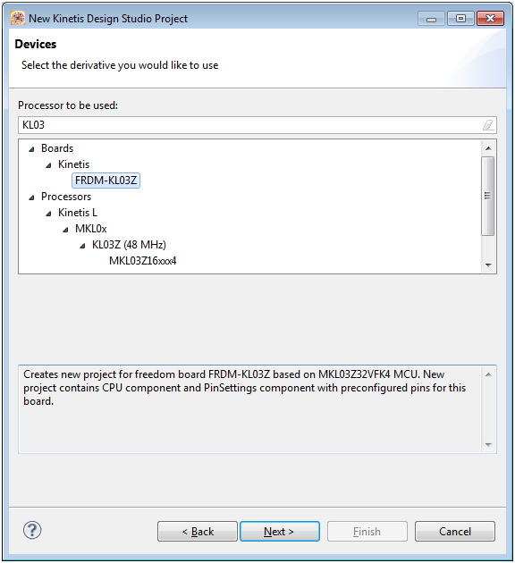

New project
When you properly install and update all the software you are prepared to create the Low power demo application.

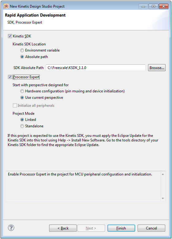

Create a new Kinetis design Studio project:
Select the FRDM-KL03Z board
Select the Kinetis SDK path to the KSDK 1.1.0 and select Processor Expert
The application is created and there are not any warnings reported in the Problems window.

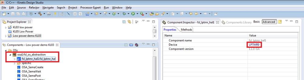

But there is another issue. The fsl_os_abstraction component in the OSs group is added into application (it was not in the KSDK 1.0.0) and it allocated LPTMR device in the inherited fsl_lptmr_hal  component:
The only solution of this conflict is removal of this component (the low power demo needn’t any OS; it is a simple application only). But this component is used by fsl_clock_manager and the fsl_clock_manager is used by PinSettings componnet. So you must remove all these component ( fsl_os_abstraction, fsl_clock_manager, PinSettings).

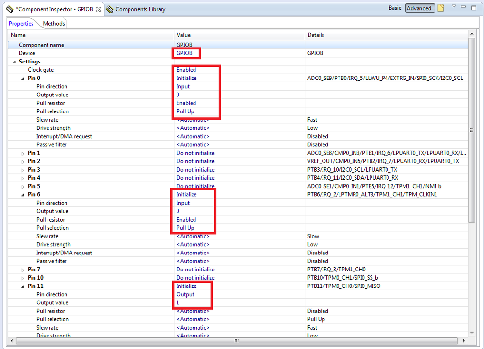

When the PinSettings is removed from the project all signal names are also removed and you must select pins in the Cpu component again:
The PinSettings component must be replaced by Init_GPIO component that allows settings of GPIO pins including routing and electrical properties.
Add the Init_GPIO component into the project and set following properties (switch to Advance view):
  • Select Device - GPIOB
  • Set Settings/Clock Gate to Enabled.
  • Set Settings/Pin 0 group to Initialize and select following properties of this pin (LLWU_P4):
    • Pin Direction – Input
    • Pull resistor – Enabled
    • Pull selection  - Pull Up
  • Set Settings/Pin 6 group to Initialize and select following properties of this pin (LPTMR_ALT3):
  • Set Settings/Pin 11 group to Initialize and select following properties of this pin (PTB11 – GREEN LED):
    • Pin Direction – Output
    • Output value  – 1

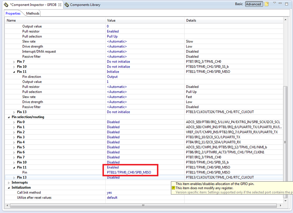

  • Set Pin selection/routing/Pin 11 to Enabled. The Pin 11 group is open and the PTB11 is selected as the Pin (GPIO functionality).
These settings provide initialization code for routing of selected pins and also GPIO functionality for PTB11 that used for driving of the green LED of the RGB LED on the freedom board.

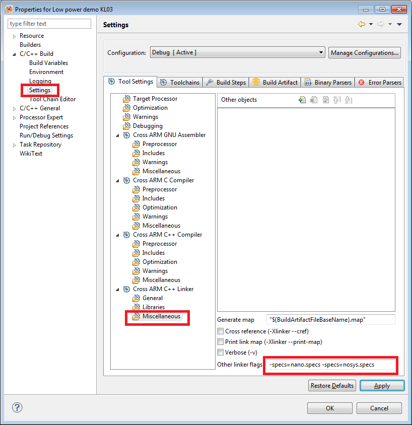

There is also necessary to change the linker settings when you have installed the new version of GCC tools (according to the document How to install Kinetis SDK 1.1.0 support in KDS 2.0.0 - Additional Steps for Kinetis L family chapter)
Open the context menu of the project, select Properties item and change the Other linker flags settings to “-specs=nano.specs -specs=nosys.specs”, in C/C++ Build / SettingsTools Settigns tab, Cross ARM C++ Linker/Miscellaneous:

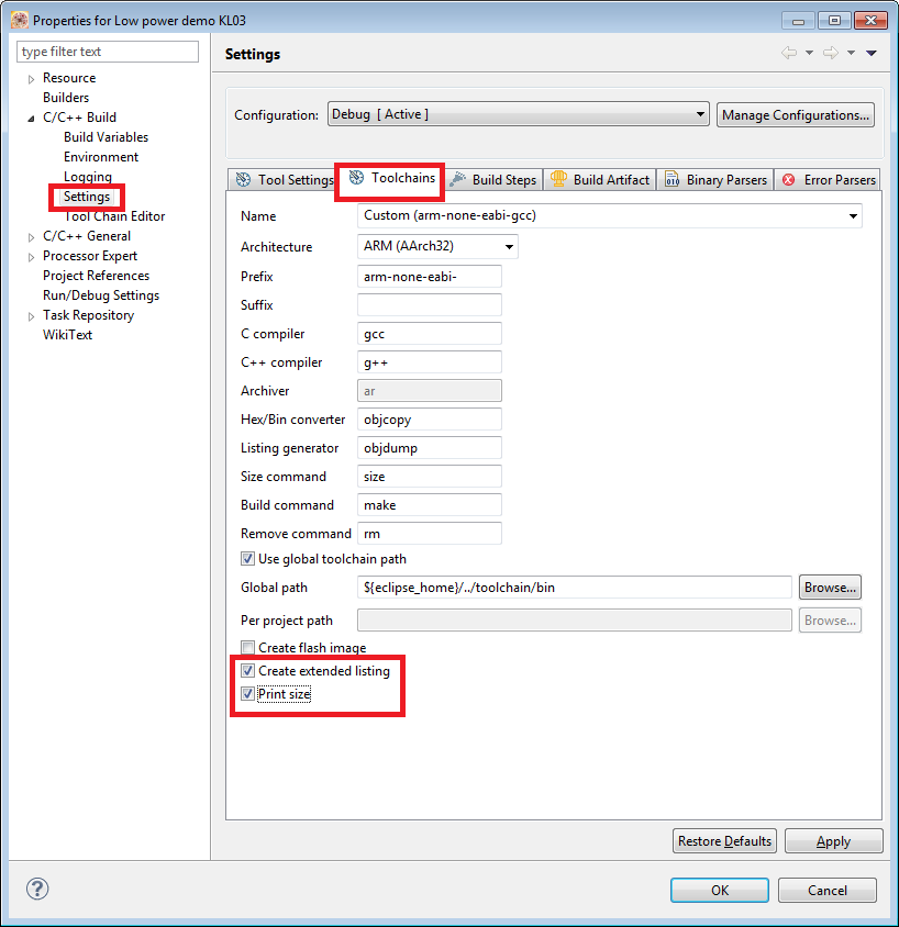

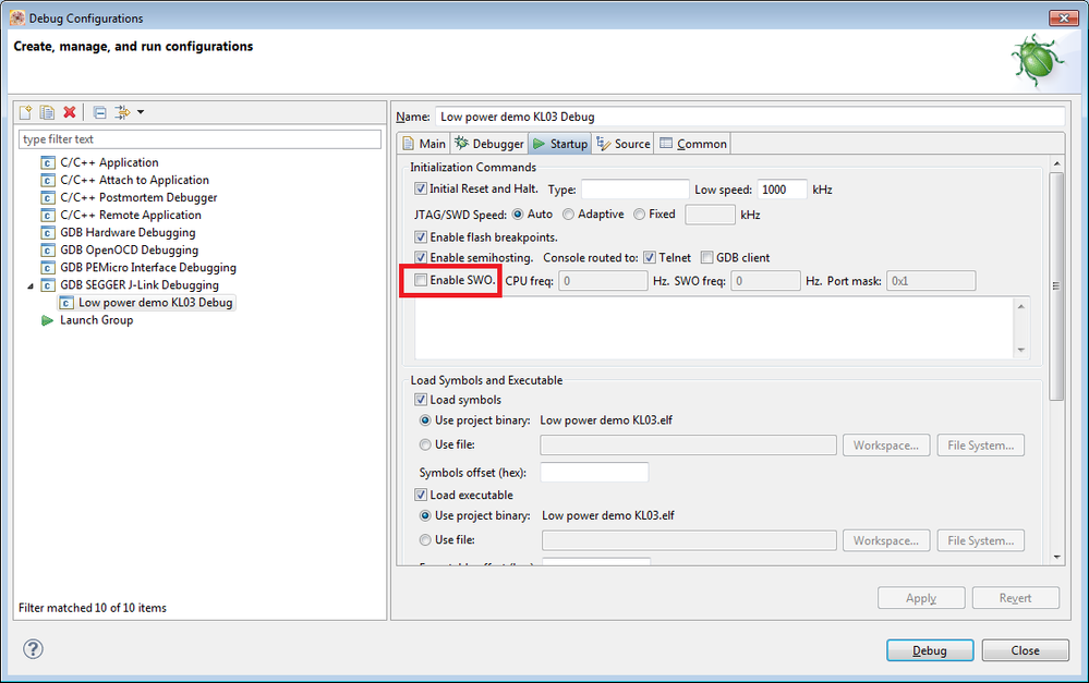

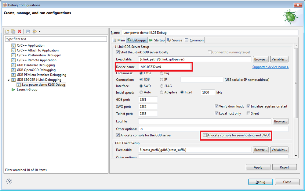

If you want to know details of compiled code and the code size, you can use the following options to create extended list file and print code size info on the following Toolchains tab:

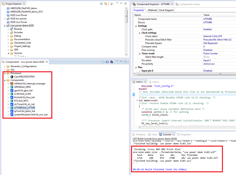

You can generate Processor Expert code and process Build of the application without any error and warning.
When the Build is finished the following information is provided in the Console window:
'Invoking: Cross ARM GNU Create Listing'
arm-none-eabi-objdump --source --all-headers --demangle --line-numbers --wide "Low power demo KL03.elf" > "Low power demo KL03.lst"
'Finished building: Low power demo KL03.lst'
'Invoking: Cross ARM GNU Print Size'
arm-none-eabi-size --format=berkeley "Low power demo KL03.elf"
text         data          bss          dec          hex      filename
1480          108          876         2464          9a0      Low power demo KL03.elf
'Finished building: Low power demo KL03.siz'
You can see that the memory footprint is quite small because all SDK component are removed.

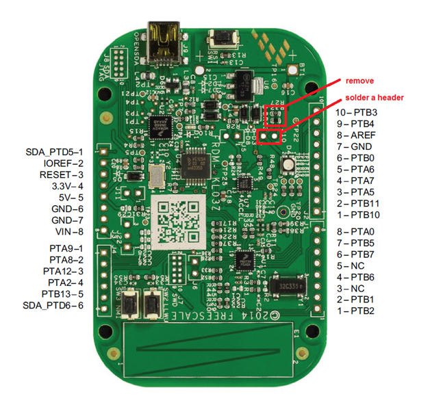

Routing of pins
Routing of pins is provided by Init_GPIO and other components in the project. There will be used following pins:
  • SW2 - ADC0_SE9/PTB0/IRQ_5/LLWU_P4/EXTRG_IN/SPI0_SCK/I2C0_SCL – input pin for the SW2 button on the board as LLWU wakeup pin
  • GPIO pin – PTB6/IRQ_2/LPTMR0_ALT3/TPM1_CH1/TPM1_CLKIN1 – input pin of LPTMR device
  • LED_GREEN - PTB11/TPM0_CH0/SPI0_MISO - output pin that driver the green LED of the RGB LED on the board
Adding Processor Expert components
Now you can add all components for the low power demo application.
  • fsl_gpio_hal to control GPIO pins
  • Init_LLWU and fsl_llwu_hal components to control LLWU device
  • Init_SRTC and fsl_rtc_hal to control RTC device
  • Init_LPTMR and fsl_lptmr_hal to control LPTMR device
  • fsl_smc_hal to control SMC (System Mode Controller) device
CPU device

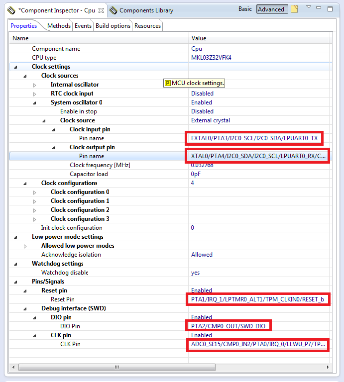

We are going to use external oscillator 32768Hz and we need to configure device to allow Very Low Leakage Stop modes. There we set following properties in the Component Inspector of the CPU (switch to Advance view):
  • Check that the Clock settings/Clock Sources/System oscillator 0 is Enabled and set Enable in stop to Enabled. The Clock source, clock pins and clock frequency are preset for the FRDM-KL03Z board
  • Go to the Clock configuration/Clock Configuration 0 and set:
    • Internal reference clock/Slow IRC frequency to 2MHz (it is enough for our demo application and it also decrease power consumption).
    • MCG lite settings/MCG mode set to LIRC_2M
    • Very low power mode to Enabled (leave setting of VLP mode entry to User because the VLLS1 mode is entered after blinking; we will write the code to enter VLLS1 mode)
    • System clocks/Core clock set to 0.5Mhz
    • System clocks/Bus clock set to 0.5Mhz (it allow us to enter very low leakage stop modes)
  • Set Low Power mode setings/Acknowledge isolation to Not allowed value (we will do it in the user code)

We have finished design time settings of Processor Expert components and we are ready to write the application code.
When you generate code and Build the application there will not be any error or warning. The Processor Expert project looks as follow:

You can see that the code size has increased because SDK functions have been used in the application.
This is partly due to usage assert function that allows reporting of error by using standard libraries. If you needn’t this functionality and you need just a compact code (to decrease the power consumption) you can do it by the following way:
Open Properties of the Low power demo KL03 application, select C/C++Build/Settings, on the Tool Settings tab, select Cross ARM C Compiler/Preprocessor and add NDEBUG symbol in the Defined symbols list:
When you Clean and Build the application again the code size is reduced:
3192          108          876         4176         1050      Low power demo KL03.elf
08:20:28 Build Finished (took 15s.886ms)
There is also additional step that allows you to reduce the code size of the application. You can set Optimization Level of GNU C tools.
Open Properties of the Low power demo KL03 application, select C/C++Build/Settings, on the Tool Settings tab, select Optimization and set the Optimization Level to requested value (please note that some of the level are not suitable for debugging):

In the Debug Configuration window open the GDB SEGGER J-Link Debugger  group and select the Low power demo KL03 Debug configuration. See the Debugger tab, there is already filled MKL03Z32xxx4 Device name. Uncheck Allocate console for semihosting and SWO (SWO is not support by OpenSDA SEGGER J-link).
Go to on Startup tab and uncheck the Enable SWO option (SWO is not supported by OpenSDA SEGGER J-link).
Click on the Apply and Debug button and the debugger starts (you must have the FRDM-KL03Z board connect to the workstation).
You can now start the application (click on the Resume button) and check the functionality. The debugger is disconnected due to VLLS1 mode entry. But the application run and can be used.
If you want to connect a button for the LPTMR pulses generating you can connect one pin of the button to the PTB6 on pin #4 of 8-pins connector J1 and the second pin of the button to the GND to the pin #7 of the 10-pins connector J2, see below:
