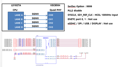

Dear NXP experts.
I developing the custom board based on ls1028ardb board
and attached vsc8504 phy to ls1028a cpu.
the vsc8504 phy uboot driver is added on uboot/drivers/net/phy/vitesse.c
 <figure1> is block diagram, how to connect vsc8504 to cpu

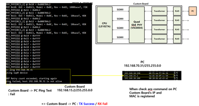

and ping test on uboot,
<figure2> is test configuration
Runnnig Wireshark on PC Side.
the custom board arp request packet is captured by wireshark
and pc send reply packet, but custom board can't receive the reply
but sometimes  can receive about once in a hundred
Please refer and feedback.
what i should do?
===================== RCW ==========================
CLK_OUT_PMUX=0
63 ASLEEP_PMUX=0
64 RESET_REQ_PMUX=0
65 IIC1_PMUX=0
66 HOST_AGT_PEX1=0
67 HOST_AGT_PEX2=0
68 GP_INFO=0
69 EC1_SAI4_5_PMUX=0x1
70 EC1_SAI3_6_PMUX=0x1
71 USB_DRVVBUS_PMUX=1
72 USB_PWRFAULT_PMUX=1
73 USB3_CLK_FSEL=0x27
74 ENETC_RCW=0x3
75 SPI3_PMUX=0x1
76 GTX_CLK125_PMUX=1
77 SRDS_PLL_PD_PLL1=0
78 SRDS_PLL_PD_PLL2=1
79 /*
80 *SRDS_PRTCL_S1_L0=0x9
81 *SRDS_PRTCL_S1_L1=0x9
82 *SRDS_PRTCL_S1_L2=0x9
83 *SRDS_PRTCL_S1_L3=0x9
84 */
85 SRDS_PRTCL_S1_L0=9
86 SRDS_PRTCL_S1_L1=9
87 SRDS_PRTCL_S1_L2=9
88 SRDS_PRTCL_S1_L3=9
89 SRDS_PLL_REF_CLK_SEL_S1=0
90 SRDS_S1_REFCLK_SRC_SEL=0
===================== DTS ==========================
